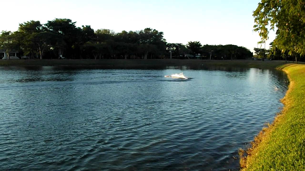

            Is that all stock with stock prop?
            Also what batts are you using and did you change bullet size to 5.5mm?
            • siberianhusky
              • Dec 2009
              • 2184
              Looks kinda slow to me, and running real wet. Where is the CG and how is the strut set, what prop.
              If my boats upside down then who owns the one I thought I was driving the last two laps?
              • Rob DeAngelis
                • 269
                its all stock... 4200mah 2s Grim lipos... took it out of the box and threw it in the water... bench tested the motor and esc... thats all...
                Lakeside entertainer
                • Rob DeAngelis
                  • 269
                  The prop is a Grim 42x55...
                  • Rob DeAngelis
                    • 269
                    The prop is a Grim 42x55... I dont know how to tell the CG all I did was set the batts in the middle, and what does "running real wet" mean??? the strut is adjusted a hair down to seat the back end from the prop upgrade... and thats all... why does my boat look slow to you??? remmember that its all stock... what gives? what do I need to do to make it faster without switching electronics???
                    • Grimracer
                      • 656
                      Robde
                      What is the biggest differance between what you see in my run here.. same prop.. same batts..
                      and your run video?
                      RC boating is a great hobby.. Great to discover and learn.. I hope you are having fun!
                      Grim
                      • siberianhusky
                        • Dec 2009
                        • 2184
                        Set the cg between 27 and 30% of the total boat length forwards from the transom, Run the strut with no angle at all. Raise the strut until the nose of the boat becomes to light and threatens to blow over backwards, now go down just a bit. Just move it a little bit, 1/16 of an inch max per try, until you find the sweet spot for the CG and and prop. You might not be able to get it right with the strut, this means you need to adjust the CG a little bit and start over with the strut adjustment.
                        You will be amazed at what happens when the boat begins to dance across the water, yours is staying glued to the water the whole length of the sponson pretty much. Takes a lot of power to push a boat like that. Get it adjusted and you will see what it can really do.
                        I'm actually running a motor with a lower kv than the stock one but a bigger prop, it's a Proboat Geico 1500kv motor. Another one of the "spec" class motors puts out about the same power as the stock motor but runs at a lower rpm, the increase in torque lets me run a bigger prop but at a slower rpm. Killer acceleration and hook up out of he turns, about the same top speed maybe a touch slower on top, Lap times are about the exact same, less cavitation at take off as well.
                        The only real change in mine is I filled the huge dips running the length of both sponsons, known as "blueprinting" the bottom and squared up all the edges on the bottom so the are nice and sharp not rounded.
                        I put a SV27 rudder on mine with a water pickup, it's a direct bolt on replacement, I kept the sponson pickup so the esc and motor each have their own cooling circuit. Installed a pair of outlets in the side of the boat so I can see the water coming out. Ran the original outlet hose as another inlet hose from the rudder.
                        You'll really enjoy it even more once you get it dialed in, It's like you discovered a hidden gear!
                        • Rob DeAngelis
                          • 269
                          cool thanks man... should i get a smaller prop with the 2030kv motor that my boat came with? im running the Grim 42x55... and I see what you meen about the small adjustments, I ran today and its getting better... now to work on the CG... Thanks again Husky!!!
