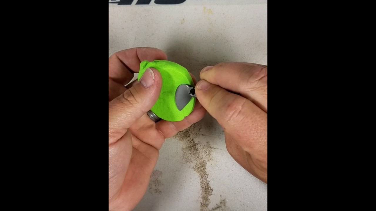

    • rayray9
      Steve Takes My Money
      • Sep 2016
      • 98
      Attachment 2:
        YouTube has some videos too

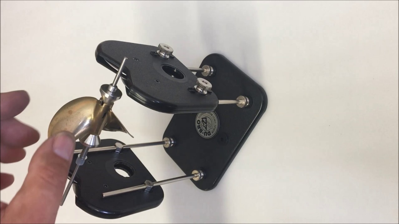

            does it matter which balancer? Etti magnetic or no name?
            • CraigP
              • May 2017
              • 1464
              There's a magnetic one on the OSE site that works fine for me
              • Prodrvr
                • Jul 2015
                • 701
                The Du-bro balancer is a bit more accurate than a magnetic balancer.

                      These are two of the most informative videos I have found on the tube.
                      • MADRCER
                        • Feb 2017
                        • 765
