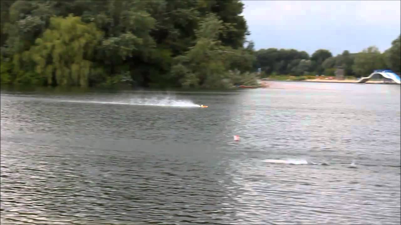

                          In Naviga there is a Mini Hydro class, for hulls under 450mm (just under 17 3/4"), I run a JAE Minisprint with the tips of its sponsons cut off (despite them calling it 17" it is a touch over 18"), with a Mega 16/15/3 300kv motor, on 3s 1500mAh, spinning a detongued and backcut X427. The Minisprint is the best <450mm rigger in rough water. In flat water the Rasch Mini Hydro is considerably faster, these differences can be reduced by using thinner wood in the Minisprint which is pretty porky if built with the kit wood as mine is, but as light as you can build it the minisprint will still be slower in flat water and better in the rough. The H&M Mini Hydro is new and I have as yet only seen 2 racing but neither were good, it may have as yet unrealised potential, but at this time I would have to advise against it.
                          My MiniSprint
                          Rasch Mini Hydro
                          The mini Hydro class is not blisteringly fast we run >5 mins on <110g of battery which at the moment is 2200-2600 2S or 1500-1700 3S, which is <200W. Here is a sample of the class.
