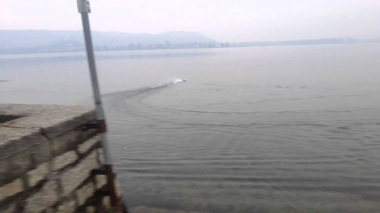

    Mini ECO from Minicatracing wins hands down!! I am on a vacation as I type and I have this with me because there are many smaller ponds here in Idaho and the self-righting feature puts my mind at ease.
    You can not compare that to a Reef Racer. I had videoed my first run prior to my vacation, the video is terrible as I couldn't see the screen on the camcorder due to the bright sun light, but you get an idea of the speed and jumping ability. It occasionally stuffs ( dives) but I did not have time to fiddle the COG, a bit of lead weight will take care of that.

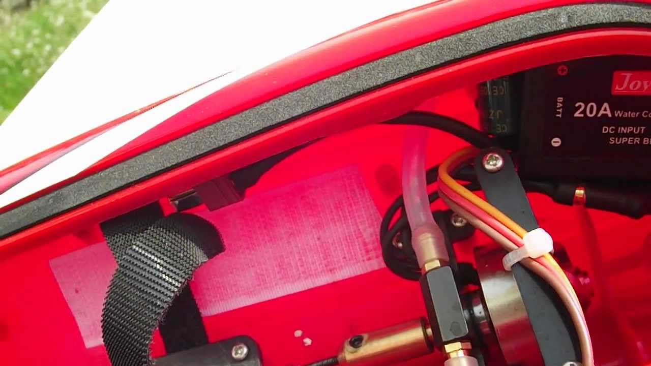

                            Hears a good video of the setup in the hull of the Joyway super mono x.
                            That outrunner should have plenty of power and torque if you go with a bigger prop,
                            But I would look for a three blade to help control unwanted torque roll.
