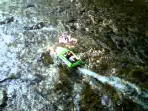

                          #42
                          Ran mine in some very shallow creeks this morning. It's hard to navigate rocks and make a video with a phone at the same time!
