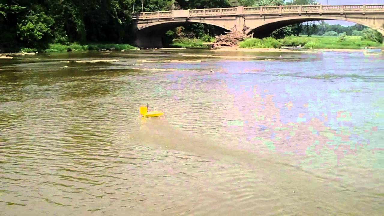

            Got the paint done as far as its going to go. So I put it together. Then I got to run it.
            • Basstronics
              • Jun 2008
              • 2384
              #36
              6x5e prop. Using some older AM XPS remotes. I didnt have the throttle setting on "hi" cranked all the way up so I was not getting full power until my last video.
              More video's to come!

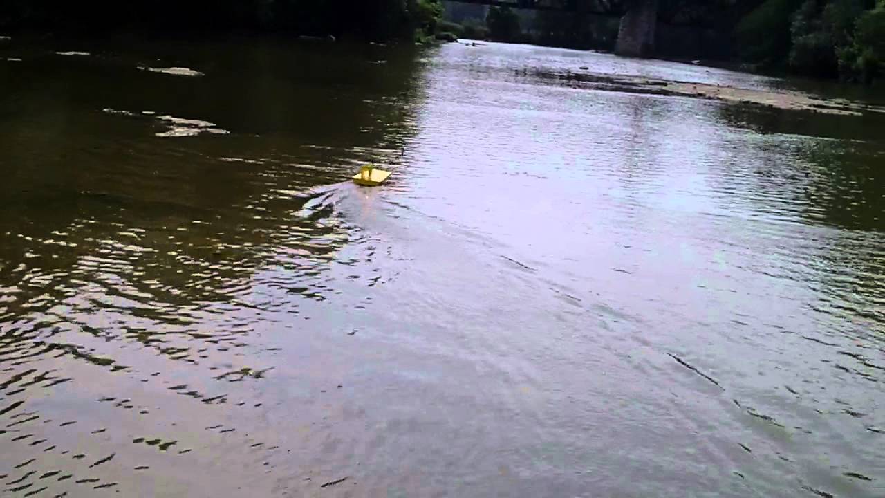

                Hi looks good.
                I bought a aquacraft mini alligator tours and converted it to brushless.
                Here it is on 2S lipo.

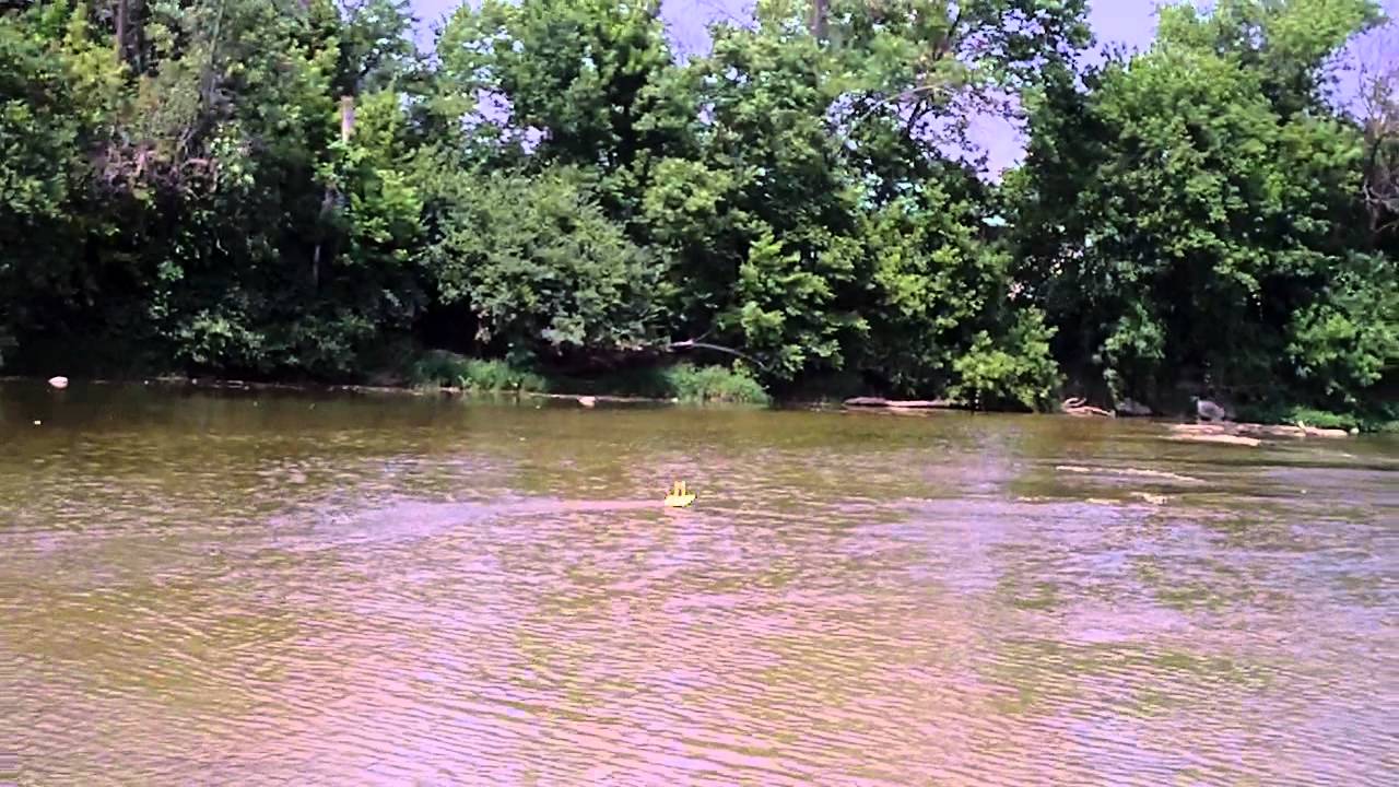

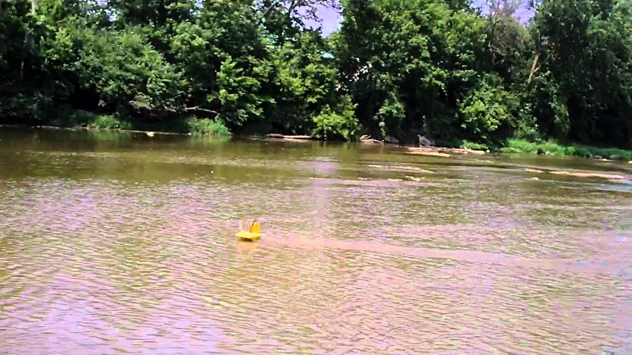

                  #38
                  7x4.5e
                  Same throttle issue...
                  8x5e
                  8x5e throttle corrected- full tilt crash! ouch!

                    #39
                    Hi years back i used to build airboats lots of guy's recomend tilting the prop on a slight angle...think it was slight like 5 to 7 degrees... try putting a couple thin washers under the bottom motor screws so it tilts the prop up tawards the sky just a hair so the wind gets thrown at a slight angle towards the water behind your boat ..play around will more and less washers to find the sweet spot you may be able to get some faster speeds and better thrust to push the boat farward .... you can even try the smaller prop that did not push it to well.
                    WWW.PPRSLOTS.COM
                    • Basstronics
                      • Jun 2008
                      • 2384
                      #40
                      Hmmm. I was thinking the exact opposite. The boat tried to take flight a few times. Especially when a gust of wind caught the sides went under the boat. When I got on it with the throttle fixed up only a bit of the boat was in the water.
                      Im quite pleased so far. Just need to get it out and try again.
                      More videos to come tomorrow, weather permitting.
                      • SweetZ28
                        • 1535
                        #41
                        I think it's just the oposit... search RC airboats on the web and look at the photos of boats sidways you will notice most have the prop angled up a little.
