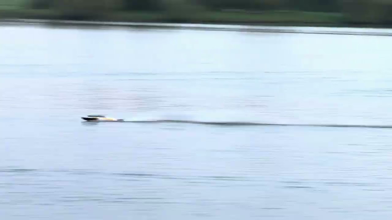

      Also how do I free up the boat, thought it was or I couldn't hit 60 mph?
      • tjsb
        • Mar 2023
        • 478
        Got a video on youtube were is the link.
        Thanks
        • tjsb
          • Mar 2023
          • 478
          • tjsb
            • Mar 2023
            • 478
            Tell me what you guys think of how its running
            • Bande1
              • Mar 2023
              • 678
              looks good dude!

                Good you posted the video that shows quite a bit. That prop is not working well, too much lift as you noted causing the tail to hop. That's a double ding for efficiency. Instead of pushing forward its spending too much energy lifting the tail. Second, the hopping changes the angle of attack on the front sponsons and causes the rears to make and break contact with the water. That also sucks power out. You need to get the prop/strut/AoA/turnfin correct so that on smooth water there is no bounce or chatter in the boat. Try 1616,1716, 1717 10-39 or 17-15 ABC prop.

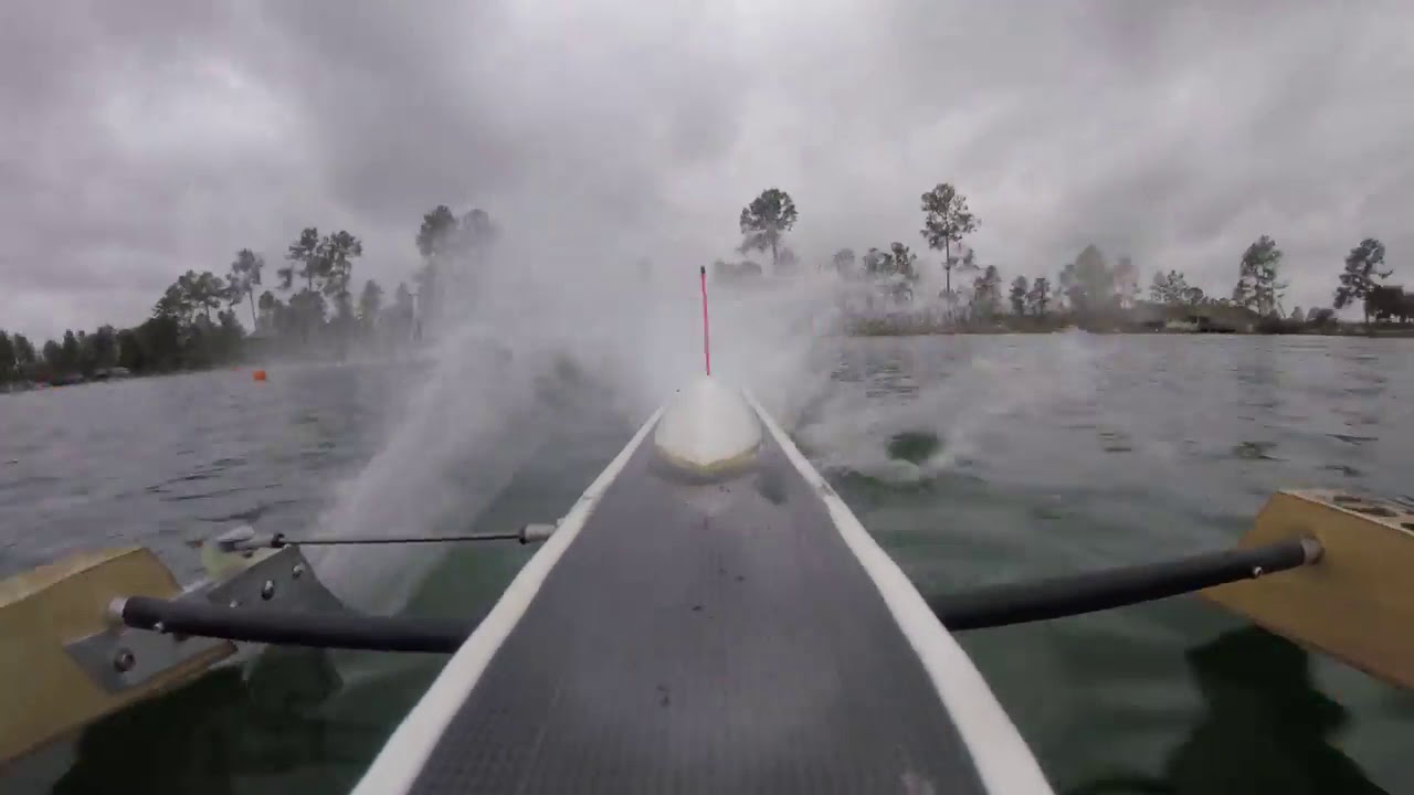

                You want to strive for this level of smoothness:
                This is a JAE mini sprint 3S 2500mAh boat with an outrunner motor. It's butter smooth and current draw is very reasonable.

                  This is a much larger 6 cell rigger, but gives a great view of stability in slight chop. This is running 77-79mph.

                    For 3750 kv on 3 cells those props are to big,even a 1614-38 was a little to big.I just ran a x640 and got to 60 mph and ran about 50% longer almost 2 minutes on a 6500 mah battery.
