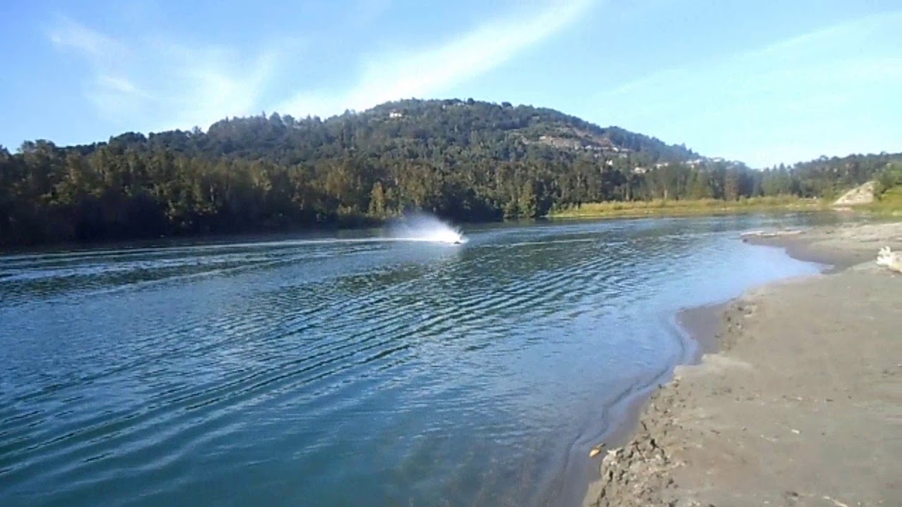

    video of 42" catamaran
    first its hoping not sure if thats a weight distro thing, wasnt doing it earlier. This is turned way down to do 5 laps on my cheap batteries. Some of you may know Ive been struggling a little setting this boat up with torque steering issues. This is the first time Ive really ran the boat for any length of time as Ive slowly sorted out issues. Pretty disappointed with my batteries not being able to go any more than this. The system is nowhere near what it can actually handle.
    GPS speed was about 55mph. data log shows 5,000w average. 12s with 6500mah Socokin 4s packs.

    What Batteries, how many cells to each motor/ what motors?

      Larry this is a single TP 5670 on 12s via 3 4s packs in series.

        I never had good luck with running batteries in series. You should have plenty of room to do a parallel set up no ?

          A 42” cat is likely a tad light with only a 1p setup in it. I would be running at least 8000mah in it. It may also help with the hopp down the straight with a little weight distribution.
          Just my thoughts on it.

            This one is a bit overbuilt with Castle 1717?s on 6s2p per motor 4000mah 40c packs running Octura 447 props
