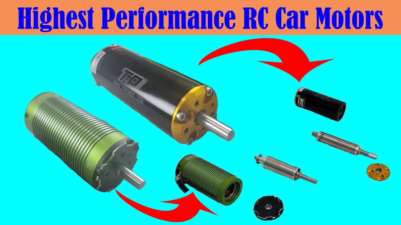

                            Originally posted by tjsb View Post
                            How does a TP motor compare and what one?
                            start here at a tear down of castle and TP motors
                            rocket 4092 - 4200w max / 2600w continuous
                            leopard 4092 - 4200w max / continuous unknown (assume about 2200w)
                            TP 4060 (4092 size) - 6200w max / 3050 continuous watts
                            we are assuming these numbers are accurate and not marking BS. What that means is W=VxA. so take you wattage of the motor and divide it by the voltage you will run. That gives your amps you are capable of pushing. Amps are directly tied to your prop, your drag, your weight, and your RPM.
                            so take the leopard 2600w / 22.2v = 117 amps
                            now the TP = 137 amps
                            Rocket RC - 100 amps
                            TP 4070 3850w - 173 amps
                            what those amps translate to depends on the KV, weight, drag. it might be 65mm total pitch, it might be 80mm total pitch in a outrigger. You really need data logging to know your boat.
                            if you go to 8s on those motors now you divide by the wattage by 30v and you get even less amps and higher RPM requiring significantly smaller prop before you overload the motor. Or you lower the KV significantly.
                            When you have a larger hull 38-40"+ you are getting too large for 4092 motors. moving into 56mm territory. 56mm are a whole different animal that usually use gasser size props 55-80mm. They are big massive amp motors with low RPM generally so there is a reason you may want to stick with 40mm cans. TP (and Lehner) make 40mm motors that are 107mm long and 117mm long and produce 56mm motor wattages.
                            Then there are the CM/SCM motors. These are ultra high RPM competition motors. for example the 4080 2022kv is 117mm long can rated for 8s. it handles 6000w continuous and 11,000w peak. Running that motor on 6s allows you to push 270 amps continuously. Which throws out all the wisdom you hear about lower KV for more torque. This motor can run both large props AND high RPM for 100+ mph because you have so much wattage handling of the motor.
