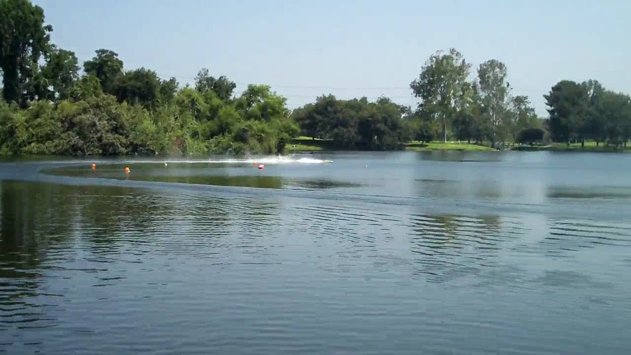

                            I think it runs around 65-68 with this motor and a X457/3 prop. It was faster with a 2215 1.5Y and smaller prop but this combo is very safe and reliable. So I can use 20-25C batteries in a 2P set-up for offshore and finish comfortably.
                            I ran 72-74 I think with the Neu motor and Schulze controller on 10S.
                            Here is pic of that set-up. One with a 40.160 and the other with a 40.300.
                            Video of it running with the Neu motor and a small prop.
