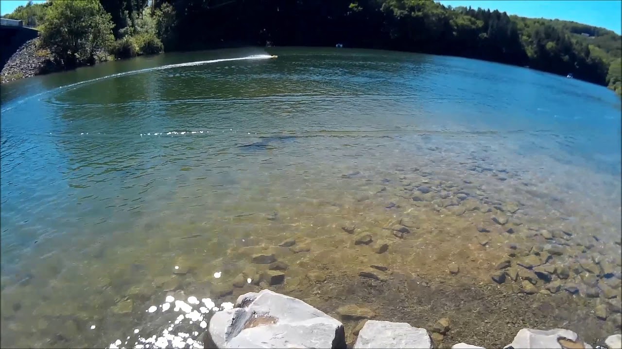

                        how fast is the sw26?" how fast you want to go? i just bought a volantex vector pro 798-2 800mm boat(thats including hardware ,its about a 26 inch boat) .has a flood chamber .out the box on 4s only 30 mph but with a balanced and sharpened abc 42x55 i got almost 39mph .you can run this flat out in chop ,if it flips over it will self right .
                        check my video .
                        its not without faults though 3 out of 3 members i know of had leaking flood chambers(leaking to inside of boat)but once fixed wasnt a issue no longer .this is a plastic boat .but the cost reflects that .212.00 shipped i got mine .40mph is about the limit of the motor esc combo .aside from a dasboata prepped prop this abc 42x55 is king .

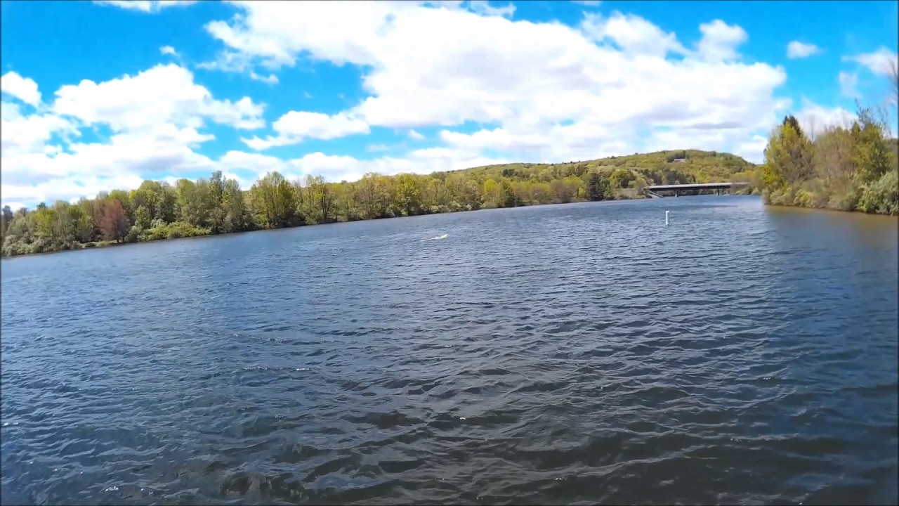

                          theres always the recoil 26 from proboat .fine little choppy water boat .expect about 32mph on 3s with a m440 prop .thats what i got out of mine .self righting works good .a blip of the throttle and she flips right over .before i sold mine i threw a 3 blade 440 on it and managed 36 mph .this is a 3s boat .i ran this in chop alot ,flipped it ,barrel rolled it ,jumped it over waves .it likes it rough .
                          here it is on the m440 running in chop at the lake
