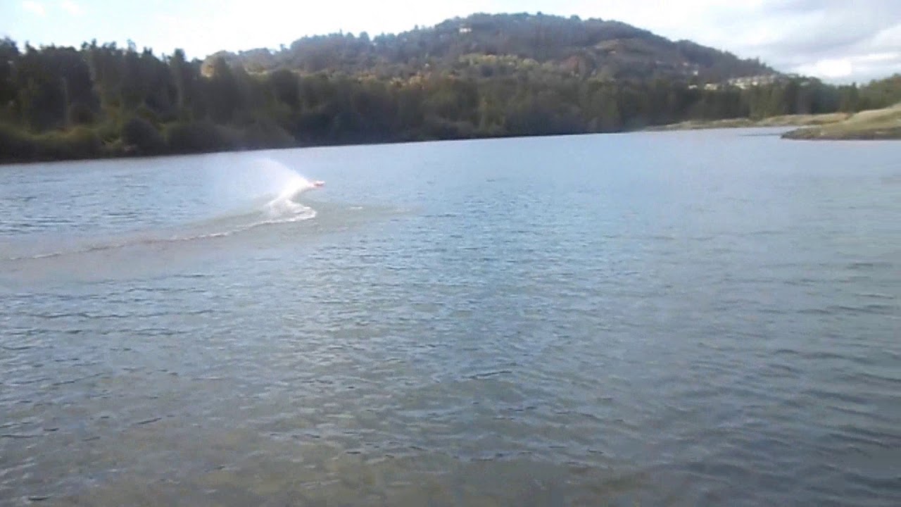

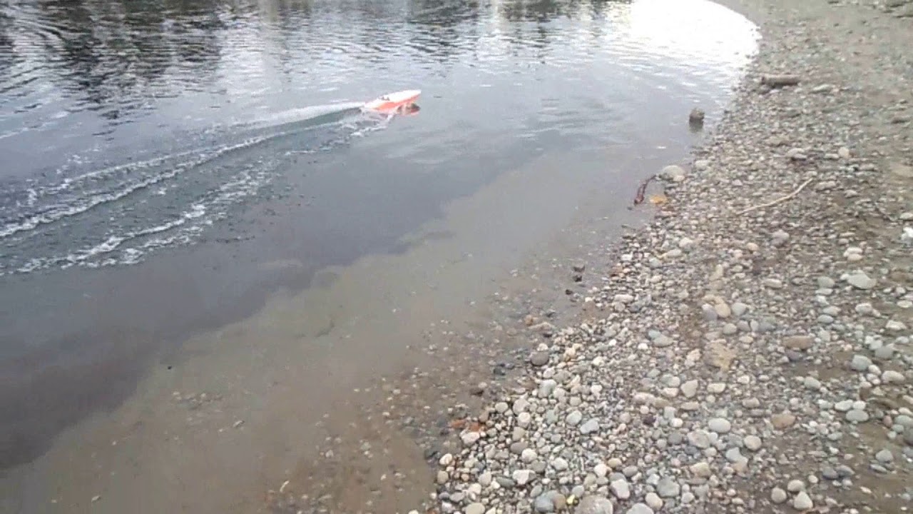

                            Steerable out drive....
                              As promised, I got it out on open water
