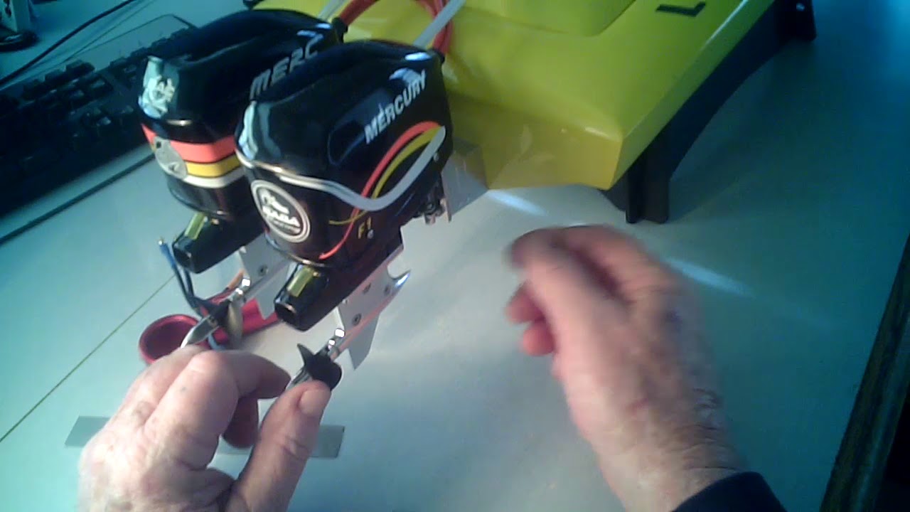

    This shows a dual Proboat layout on a 900 mm hull. Later testing showed the props to be about 10 mm too low. Once adjusted upwards the boat planed well with no ill effects. The builder has several videos of the boat.
    Outboard adjustment on the prototype

      Yeah, what I'm thinking is that the center of the forward edge of the anti cav plate should be inline with the bottom of the hull where ever where each engine sits.
      Ie if the motor is centered, the cav plate is at the level of the bottom most point of the V. If offset to the side they will need to be raised to accomodate the rise of the rear of the transom.

          these outboards are surface running setups and I have experience setting up surface run race motors I just never have mounted surface run race motors on a DEEP V.... so this is what presents new challenges and questions for me
          I set my twins so the prop shaft is even with hull bottom and have a ton of adjustment to move upwards for performance which I believe they will need to be raised higher still & they really cant be lowered much more anyways
          but im sure the prop shaft needs to be even with hull bottom and a wee bit higher to tune it in, its the same way I setup my real mercury race motors with same surface running gearfoot (see photos)
          notice this 50's model race motor still has the cav plate although the gearfoot is set so that the prop shaft is above the hull bottom today they have done away with the cav plate on these surface running racing gearfoot with surface piercing props
          if these RC outboards were real they would be setup so high that only 1 blade of the cleaver or chopper style props are in the water at a time, thats how high they are run
