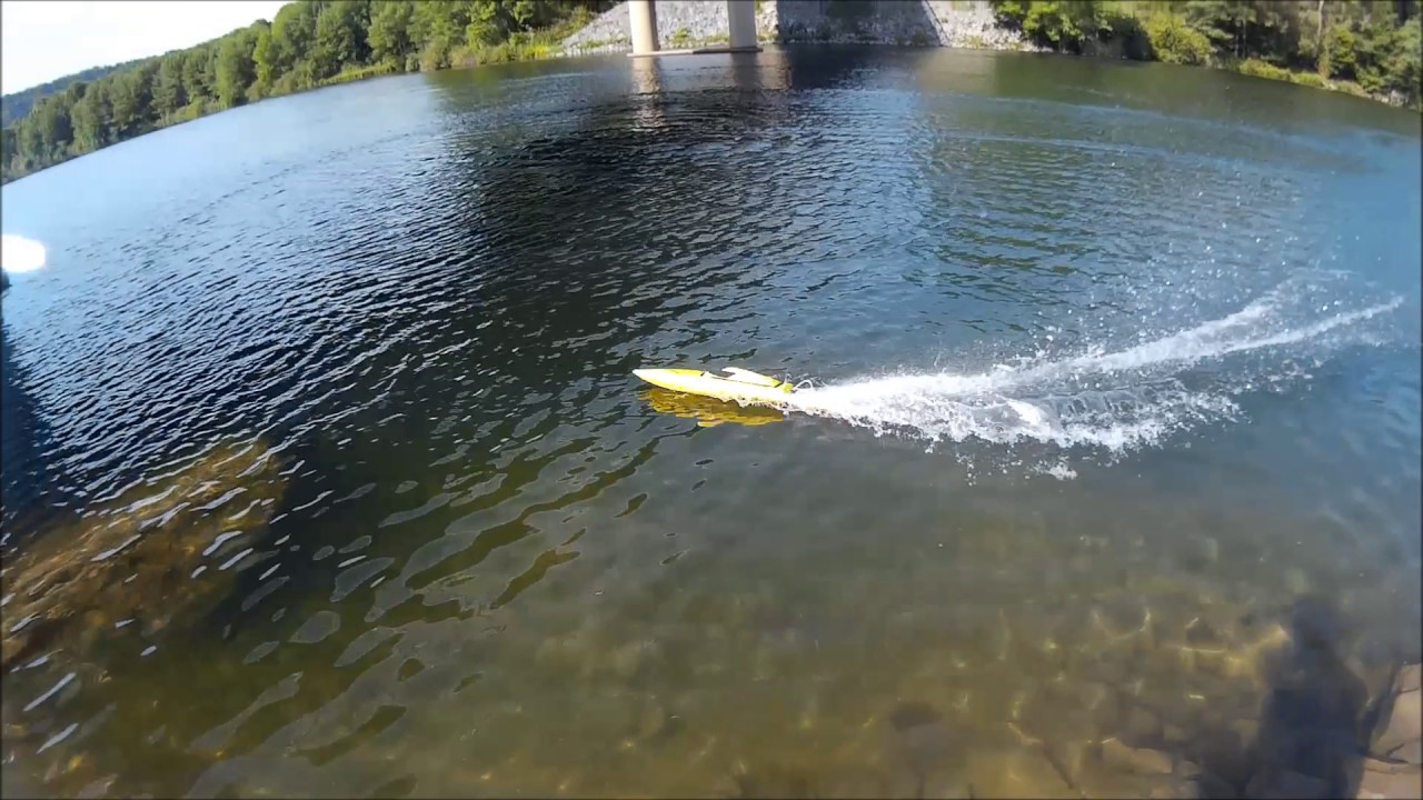

    well i put lipo trays on both sides of the hull and run 2 -3s lipos . i have no chine walking and i am running above 50 mph .57.4 is my best so far .
    heres a video of that run .
    special treat if you watch until the end .

      [QUOTE=boatsrnew2me;699787]well i put lipo trays on both sides of the hull and run 2 -3s lipos . i have no chine walking and i am running above 50 mph .57.4 is my best so far .
      you are running a leo 6S upgrade motor so its easier to add some trim tab to calm it down and still have speed
      Im still running the stock motor to learn the boats setup and get the most out of it while stock.
      I can get rid of the chine walk but suffer some speed loss, and maybe its the 1-2mm hook on each side of my hull at the transom, Ive seen posts where guys are asking about this and with the number of 6s videos of the pursuit chine walking maybe it is a hook issue
      what prop are you running.....regardless good on you most videos show them bouncing all over like mine does
      edit: I watched till the end and nice that you can make fun of yourself like that

        yes i am running a 4082x2 1600 kv leopard with a ose x645 prop . and yes i slipped on a mossy rock and fell in at the end...lol.luckily the s7 edge is somewhat waterproof.
        i guess my lipo weight on both sides the hull helps keep it stable . i never tried the front lipo tray .i dont own a 6s lipo .never messed with the trim tabs yet .
