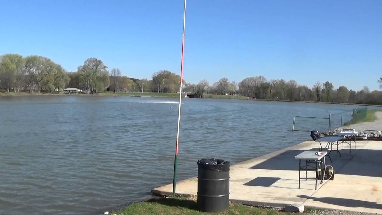

                  If you have the shorter 39" version the motor combo will be OK, but know that is the upper limit. The 4070-1650kv motor is pretty hot for a mono and will require 6S2P. Several of us run that motor for Q hydro and it pulls pretty healthy amps in the 200A range. Start small with a 447, run 3 laps and check temps. Work you way up to larger props. A X646/3, 447/3 or X450/3 will probably be as large as you want to go.
                  Some layout ideas. This is my MkII DF39". I run a Lehner 2280-1233kv on 6S2P 10,000mAh minimum. I find the key to the DF hulls is keep the CG fairly far in the back to keep the nose from bow steering in the turns. I would set yours up to allow some CG adjustment by means of shifting the batteries. I have tested the higher kv options with small props, but found the lower KV motors in the 1200kv range swinging larger props run better particularly in race water.
                  Here is what you can expect:
                  Tyler

                      Mike,
                      The motor size is correct, but in the end you will likely find the lower kv with larger props runs better and cooler. The 1220kv would be an excellent choice for the second round.
                      I would start with 2 blade props for your build. I run three blade props on mine with the 1233kv motor. I believe the prop in the video is a X460/3.
                      Typically if someone does not add a slash and prop blade number you can assume it is a 2 blade.
