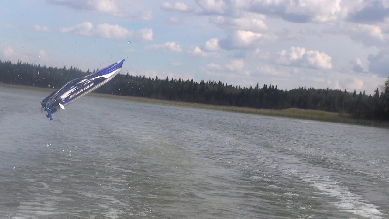

    watch this video .watch around the 2:22 mark . watch this plastic spartan do a flip over ,slap its nose against the water ,bounce back over and recover and not break a darn thing . nor lose the cover ,and no tape . sure he could have got lucky ,but would a f/g hull fare as well?
    i do not think a f/g boat would have survived this based on what i have read and seen .
    convince me otherwise .

    Carbon fiber is superior to fiberglass and fiberglass is superior to abs.
    No need to convince you... But I will tell you that a f/g boat would survive that with no issue.

        They both have their advantages. ABS is incredibly quick and clean to mould compared to glass which gives much cheaper production costs. Glass is stronger and stiffer for a given weight, and sharp edges are possible with glass.
        ABS is available in many different thickness, and with glass you can have in any thickness, and use E glass or S glass, and polyester, vinylester, or epoxy resin. You can't say one is stronger or weaker than the other as 1 may have more material in it than the other.
        I've seen ripped, cracked and holed hulls, broken transom's, split seams and breaks where canopies pins secure covers, in ABS, styrene, glass, wood, carbon, kevlar, carbon/kevlar and Dyneema. There is no material you can make a boat out of that can't be wrecked in a bad enough crash without adding enough material to severely stint its performance with weight that is unnecessary the vast majority of the time.
        I have never used gelcoat myself as it is purely cosmetic and I am a racer so I don't want unnecessary weight. Epoxying the mould, laying a sheet of 25gsm cloth and letting it gel before continuing with the lay up reduces pinholes and print through sufficiently for me. Most of the hulls I have bought that had gelcoat only had a thin layer to stop pinholes, a couple have had thick layers and while it is pretty with a even opaque coat, it is less flexible than the glass under it so can crack. As gelcoat isn't structural any cracks in it aren't either, but spidercracks aren't pretty.
        The blowover at 2:22 was not a big hit, when they hit sideways and almost instantly come to a dead stop it puts much more load on things. I see several worse at every race without damage, it is usually hitting hard things like boats, banks and buoys that damages boats at that speed, although boats can easily get wrecked from blowovers at higher speeds.
        He didn't lose the cover, but it may well have lost its seal, as after the run at 3:25 and again at 5:17 you see him pouring lots of water out, so his electrics are living on borrowed time. I would tape it if I were him.
        I feel obliged to say that operating a FE boat when someone is in the water is idiotic.
              that boat does have a seal persay .they call it a drip rail .no sealing material at all .traxxas claims everything inside is waterproof and it has a sealed rx box .

                Not really much of a debate here, other than you telling guys that have been doing this for years that what they are saying is different than what you see in a video or have read. Yes, all boats have a breaking point... so all boats will break.
                It can be left at this... 99% of the experienced boaters on this forum would not own an abs hull for serious boating.
                For funning around (sport) boating... maybe. I have two Recoil 26s... for playing around in Lake Michigan.
                And don't compare what a Spartan did at 45mph verses what a serious c/f or f/g boat did at 80mph. Not apples to apples. Get that Spartan to 80mph and watch what happens. Lol... it won't be pretty.
                If you want to sport around and have fun on the river, go buy an abs boat if that's what you like.

                              One bent rudder is all I remember. Some even drove away. Even if the Spartan could go as fast as these then crashed, there would simply be a debris field and not much more. ('Tho in all fairness, real SAW boats are in a different league entirely)
                              Last month Brian N. performed these all day and drove out of it when there was upright landings :
