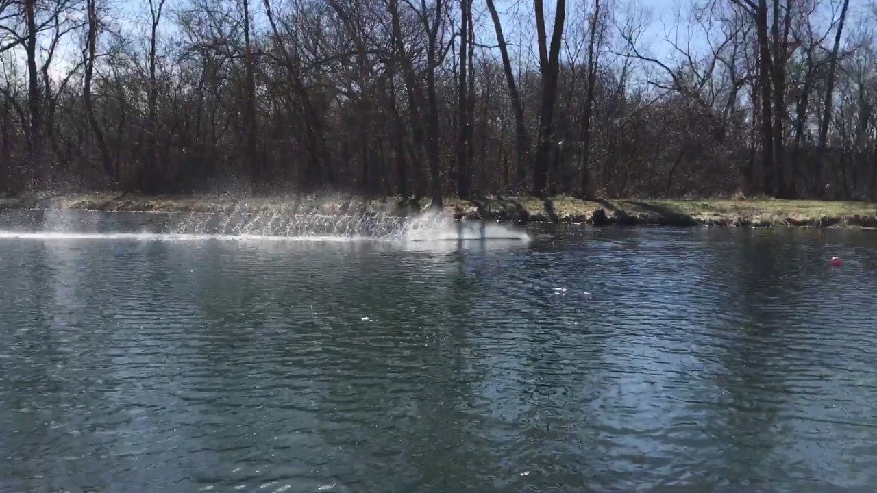

                      I finally got to get a little test run in on this. Handled really well for tossing in a pack right off the bench. Temps were low after a 5 minute run on a 2s SMC 6500 pack, but the ice just melted so water temps are chilly. Used a 42mm cnc prop I may go up depending on temps when the water warms up. Got a short video of my buddy running it he didn't want to hold it wide open Lol

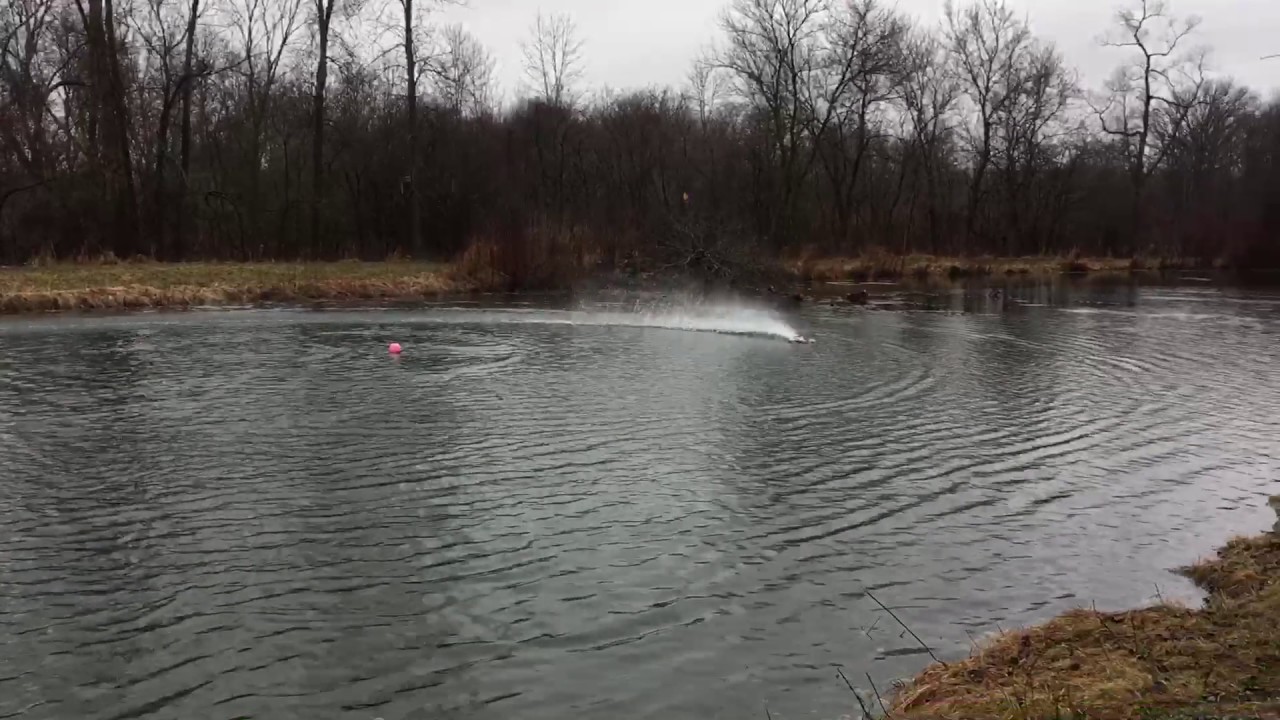

                        Here is a video of me running some laps with the rigger. Really liking this boat its much more convenient running one lipo instead of two Lol
                          Running better.

                            Running better.
                            Thanks. I have the front sponson adjustments as high as they can go (bow of tub up all the way). Not sure if I should lower the bow down or what, I will take some pictures later, maybe someone can point me in right direction. It seems to run good but I'm curious what adjusting the sponsons obtains.

                              Ran it on a 3s pack
                                Looks good, sure uses all of the water available there.
