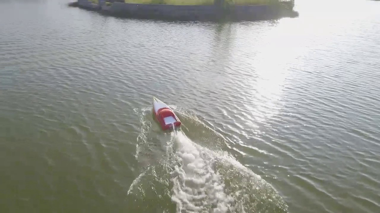

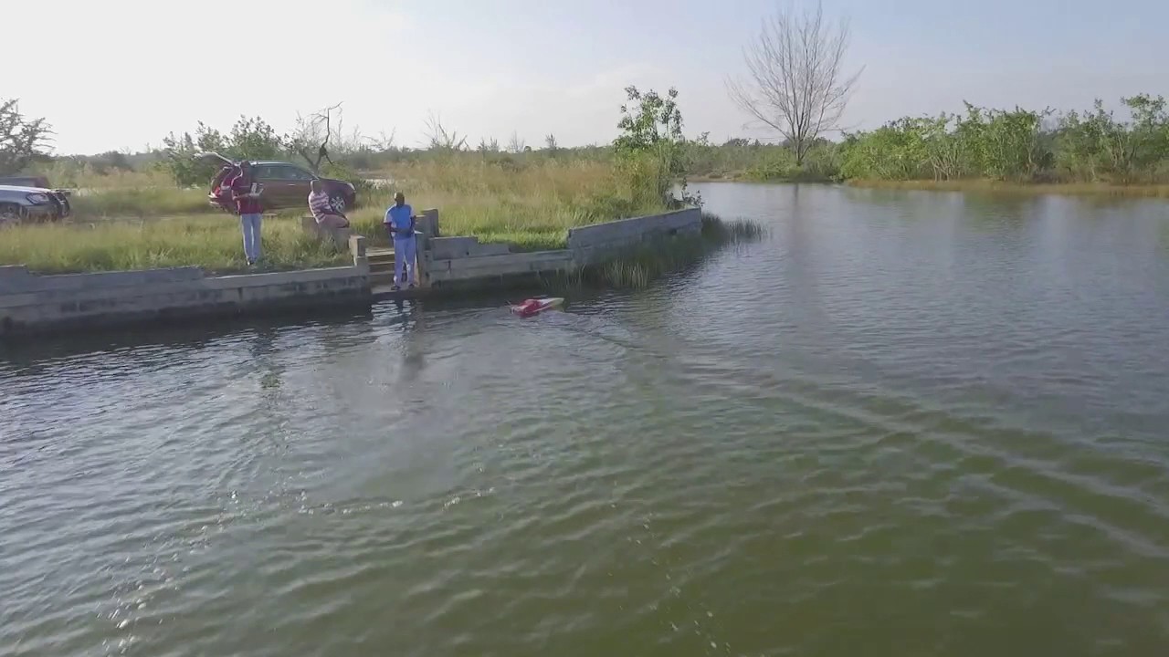

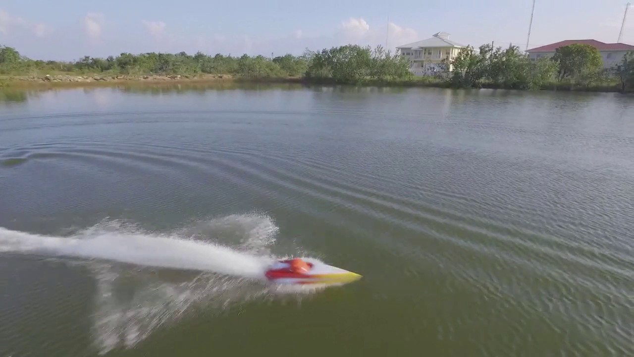

          Boat weights 25lbs. It should be all set and ready to go.

            ok the little boat that could. Clocked 46.8mph on its second run. First run about 2 weeks ago it could not go pass 15mph.
