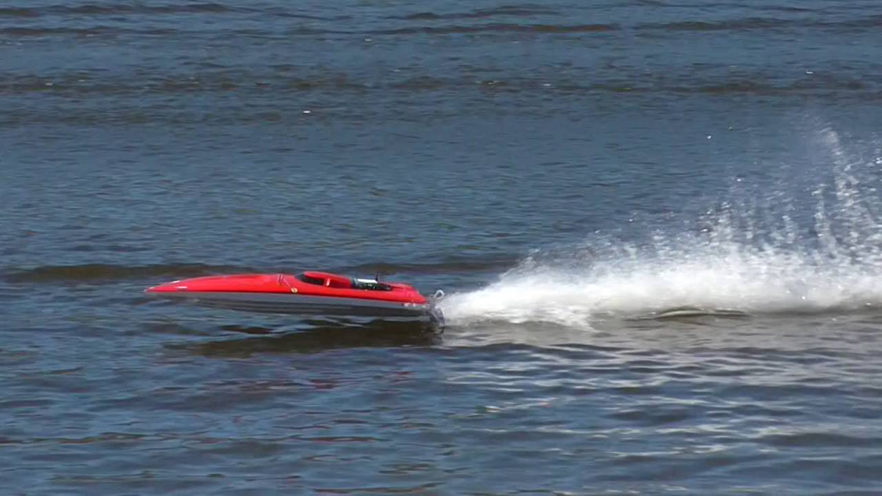

    Here's mine in the 6s mode running against 39 & 40 " boats. Mine's the white one.
