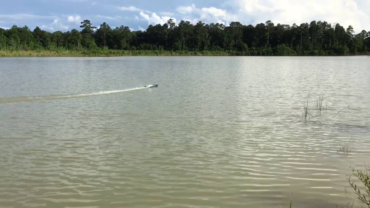

                        Wish me luck. I just charged up some batts (not to full voltage though) and I'm gonna video it this time. I'm sure something will go wrong. Lol
                          #117
                          Guess either the water conditions weren't as good as last Sunday or I made a change for the negative. I polished the prop and rudder. Maybe that hurt it. I didn't charge the batts all the way either (4.22v) to be fair as far as power goes. I'm charging batts back up right now and I'm gonna head back out there and make another few passes. I may change props this time. I had a bogus data log that scared the bejesus out of me reading like 198f so that's part of why I haven't gone up on prop. I checked temps today with my temp gun and the esc and motor never got over 110f so I think I'm easily good. Here's the two vids I got just now. This thing is super stable too. Water wasn't as smooth as I liked but it didn't care.

                              That's still pretty darn fast!!
                                #120
                                Well I charged packs all the way. I didn't think it would make a difference and it didn't. I did scuff the rudder and prop back up like I have it. But. I just remembered that my normal flex lube concoction was not used today. That may or may not have a bearing on it. I'm kinda thinking it did. I usually use a light amour of grease and some motor oil. This This I just used motor oil. I'd be willing to be the grease mixed with the oil doesn't wash oil as quickly as just oil. I'm making no changes other than that and I'll do it again this weekend. Regardless I got several high 90's passes in with not one dang flip. So I still call it a win. If the flex lube is the difference I'll be stoked and I really think it was.
                                Here's another pass.
