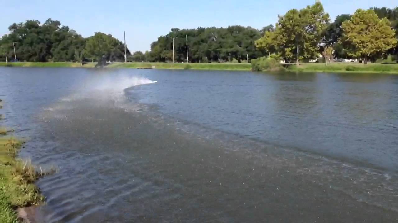

        I don't think a Rivercat would be a good choice for oval racing. There are some people who have done it and say they run well but I don't see it. With a long rudder and a prop in the 40-42mm range it can do decent but nothing like a cheetah. 60-65 mph is nothing for a Rivercat however. Very stable boat at that speed, just not stable at turning at that speed, it's just not wide enough. It's around 9" wide and a cheetah is like 12" wide. I can double check those measurements if need as I have a few of each on the table right being built. The cheetah is more suited to what you want. It can go really fast and turn very well at 65ish. Here's my buddy's cheetah that I built for him. I gps it myself on 6s, it goes 66mph. He said he's not lifting the throttle in the turns.

          Thanks for all the replies! Great information there. Glad I asked. Now I have another decision to make. I am mostly interested in a good handling fast and fun boat. I do like speed but I am not the type that will do a speed run, slowly turn around and then do a speed run back. I do like to use all of the pond though LOL so wide sweeping turns at high speed are fun. I am not as fond of the looks of the Cheetah but it does sound like a good fit. If I decide to race later I now know it would be the better choice. Now I see why you guys seem to have so many boats!
