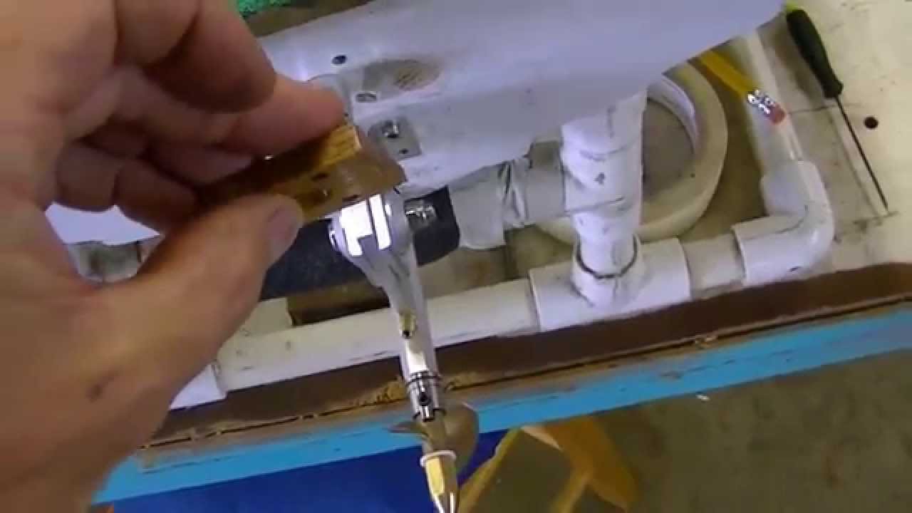

    I was given this hull about a year ago along with a Graupner drive. I installed the drive and proceeded to blow the motor because I overvolted it by 12 or so volts. LOL
    I bought an Aquastar 2200kv motor and some aluminum parts and set out....I get about 4-5 minutes of run time and the batteries get real hot. Last known amp draw was 107 before the esc left us. I'm pretty sure it was defective.
    The specifics:
    Turnigy Aquastar 2200 kv brushless motor
    Castle 200a ESC Hydra ice2
    Octura x440 prop
    Turnigy Nanotech 65-130c 5000mah batteries.
    6lb 7oz without batteries.
    1lb for each battery (2)
    Here is the maiden run:
    I think I need to prop down, but being a Noob, I have no idea what I might need. I started at the x440. I looked through the list of Octura props and I just cant settle on what I need. Smaller diameter prop? Less pitch?

    Here are more pictures.
