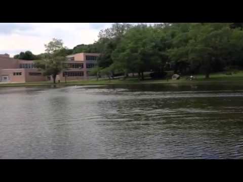

                          I love my boats even more after today. I want to thank all the members that chipped in with all comments. Special thanks to Steven with all the parts needed to support the offshore hobby. MY BOAT IS RUNNING GREAT AND COOL. BIG UP TO M440-442 props.
                          I owe my accomplishment's to all you guys. To many names to mention, thanks again , I still have a lot to learn but was very happy of the results and wanted to share it with you.

                            Sounds like an OSCARS' acceptance speech... lol...
                            Would love to see vid. Was that with 6s?

                              I was in the mud hole on 6s and had a good run.
