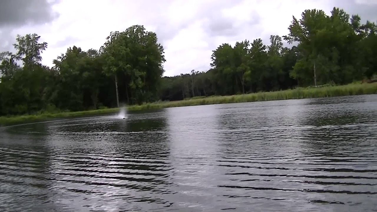

                      Zoom zoom.
                      I am sorry but this is funny to me and very wet to,
                      Just say no and do not drink a drive when testing a new boat setup.
                      Bang bang boom *!***!***!***!**.
