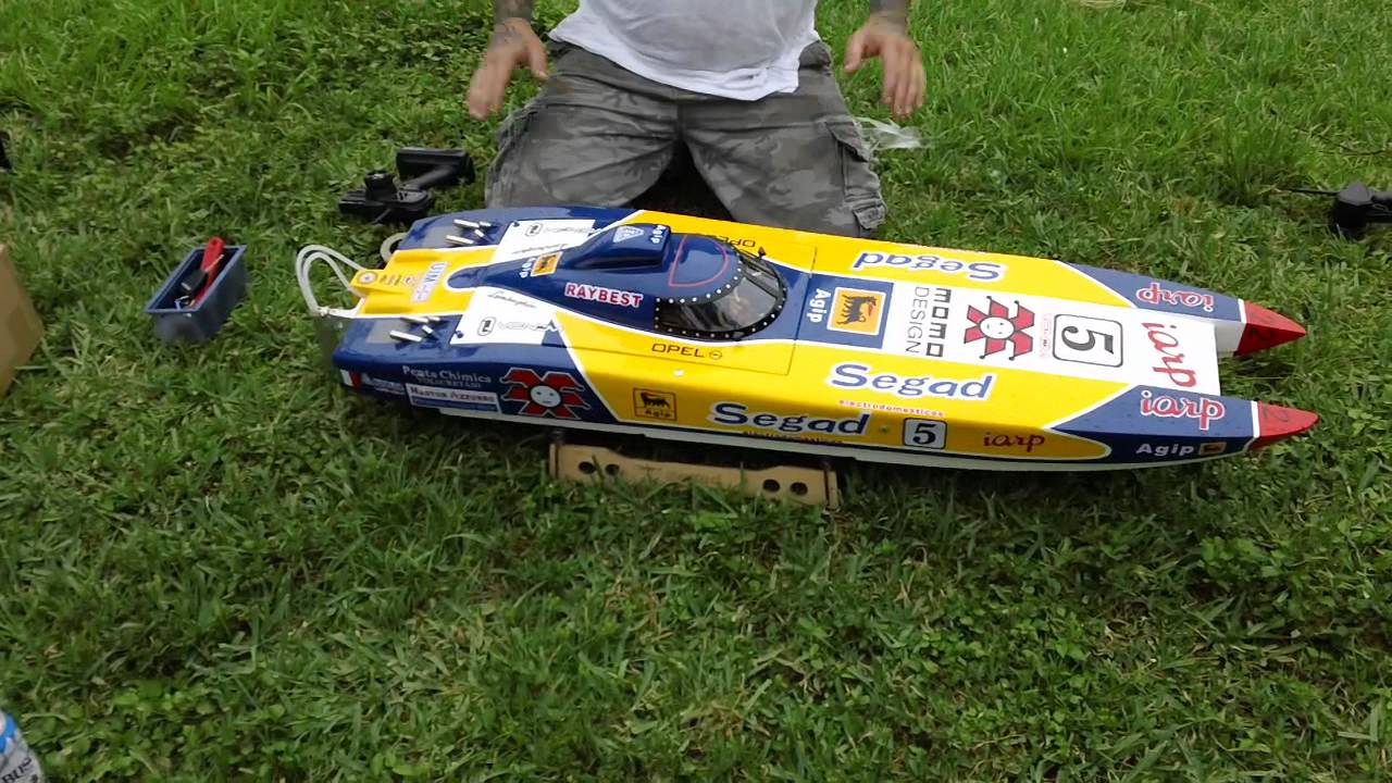

    I have a good esc already and wanting to push this big boat over 60mph. Can I do it with 6s or do I have to go 8 or 10s also what motor would you recommend ?
  • iridebikes247
    • 1669
    I would not even try running 6s to make that boat go fast. The big boats make a lot of power because they use high voltage. Sure you can get a tp 5840 1600kv motor but you'd better have a monster esc and run 6s2p. Its just not worth it when you can run 10-12s with cheap motor, and cheap batteries. For that boat you can just use a castle 2028 on 10s2p you'll see 65mph no problem. I wouldn't give it much more thought lol.
    --also be weary when taking advice on forums not everyone owns a boat of this size and what works on paper may not during summer months under load. The last thing you want is an over amped component branding your hull forever lol. A good setup will run all day every day, a bad one may not last more than 2 pulls of the throttle. hope this all helps good luck and post pics of your build.
