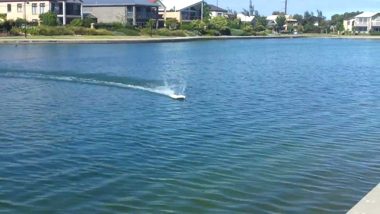

    hey guys,
    this is what happens what your boat starts to go mental, the happens at 51.6 mph haha, lucky we didnt lose the gps.
    before
    after haha

        Looks like Doc was driving and missed the duck but hit the wall.
        Before the crash it was running nice a smooth.
        Then it just went fkat out in to a wall.

              Once these hulls go over 50mph you take a chance of them lifting off and the impact with the water will disintegrate the hull. I know mine did the same thing a little over a month ago. These hulls are designed for speeds under 50mph.

                we got the hull dialed in so it won flip, the run before i flipped it and the hatch unstuck on one side and let water in and i think the receiver got wet even know its in a balloon... and then i put the boat back in the water for another run and on the first straight i lost control

                  Did it run into something? Or just turned and caught an angle then all hell broke loose?!?

                      they are thin alexgar lol, no it just went fkat out in to a wall

                        dont feel bad i lost radio contact with my modified brushless elam some time back and smashed into a dock with simular results, i should have set the failsafe
                        • borgie
                          • Dec 2012
                          • 101
                          mine had a fail safe but i wet the reciver and the rest was history lol time to upgrade to futaba and sell the flysky

                            My flysky/hk esc had the failsafe set to full throttle from the factory what kind of crap was that?
                              Why not just water proof the one you have with water proof spray or just buy some better balloons ?
                              That is what I use for all of my boat receivers,
                              And if one gets wet in the balloon just stop running and let it dry good.
                              Than you can put that money you saved with the water proof spray or better balloons toward a better boat.
