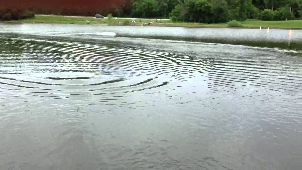

    This was the initial run..... the first 5 seconds are great, after that is was a slow burn to nothing....

                          So, the build went great and the bud runs like crazy. It is a very hard boat to beat in a straight line. I ran tests against a modded sv-27, miss geico, and a pro boat (5s only). I ran 6s in the Budweiser select. The engine was only slightly warm after a full run, batteries and connectors cool, esc did not real get past warm. The pro boat was far more stable at its top speed which was slightly slower. The bud tends to bounce from side to side a bit, but there was a little chop so that might explained it. Video is attached of a speed run and subsequent crash once I got off the throttle.
