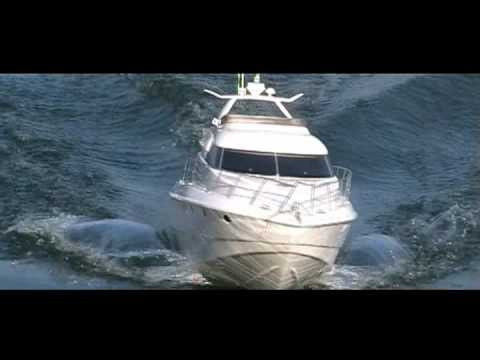

Hears a link to a good setup for that boat hull.
http://forums.offshoreelectrics.com/...-Princess-boat
http://forums.offshoreelectrics.com/...rincess-maiden
I am not sure what speeds you are getting with yours with no gps or video's of it running.
