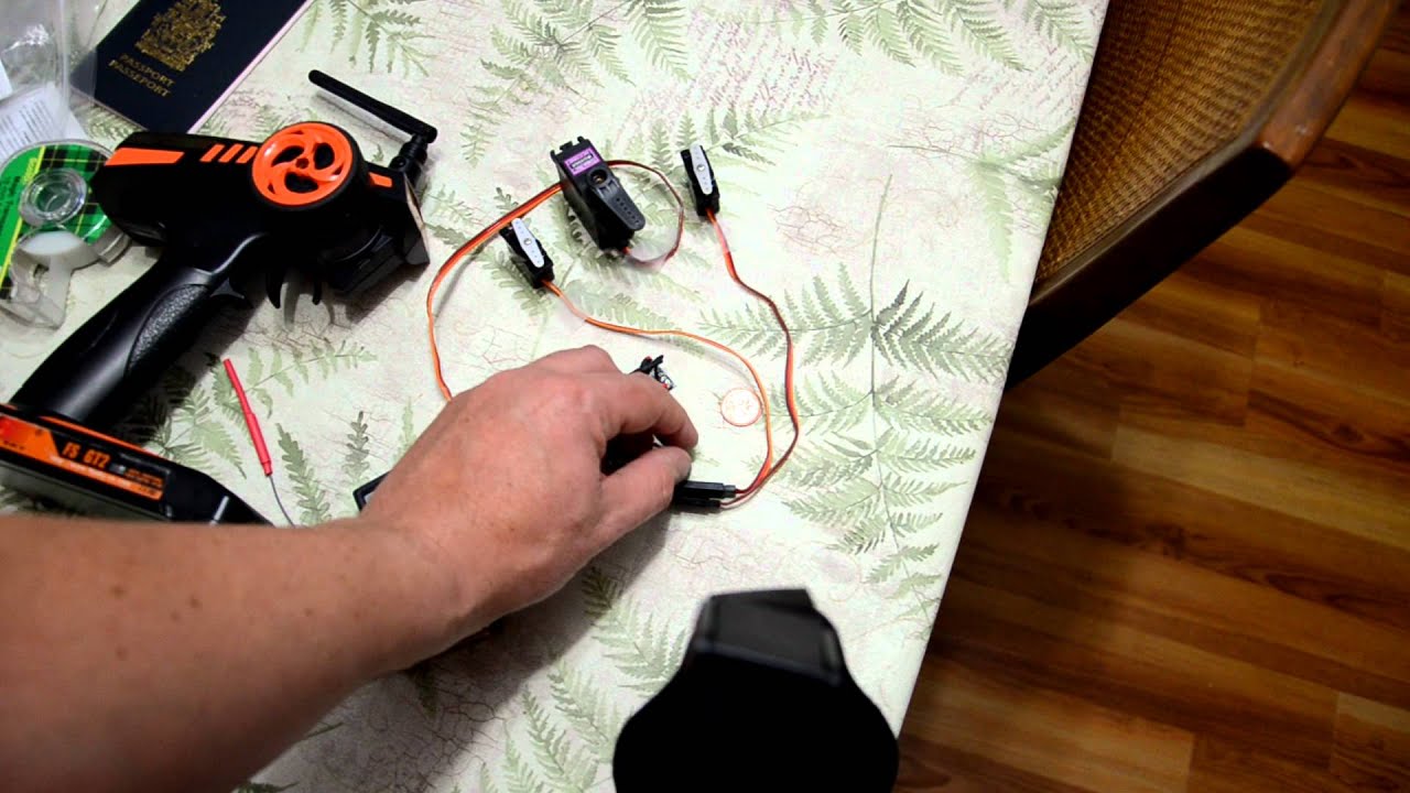

              On my Flysky IT4 I have a mix setup where dual motors are controlled with the trigger, then when i turn the wheel one motor slows down based on how much steering input I add. If I don't use the trigger one motor goes forward the other goes backward
                I have the exact gizmo for this situation

                    Would this work?
                      Originally posted by St3alth_Frenzy View Post
                      The problem with that one is that it is either forward or reverse on each motor. The one that I had made has a potentiometer built in so that you can adjust the input on each one.You can slow one motor down alot or a little.I went thru hunting all over for this till Heyok said he could make me one.
                      Originally posted by paultbg View Post
                      guys, thanks to all for your contribution.
                      @srilash - can you let me know what exactly is that mixer and where I can find one?
                      Regards
                      I have one here or I could have another made for you Paul. The one here never made it to its home in my FighterCat Shocker as it is resting at the bottom now.That was to be the gizmo's home. Let me know if you want one.
                          I think this one is similar:http://www.ebay.co.uk/itm/1110197150...84.m1438.l2649
                          @srislash-how much will be one from you?
                          Regards
                          I paid Heyok $50 for mine. I can ask him what he would do another for.It may be better as this one was a one off.But this is a hand made item not a chinese knock off "one of a million" kind of thing. That e-bay one would be like the robot one I imagine.Interesting though. I didn't think of it but one could just go rudderless with one of these.Could be good for SAW use.
                            I got an e-mail off to him Paul.That e-bay one would do it for your scale project though. Give me a bit to chat with Heyok and see if he'll be able to do a few at a better price.There has been a few interested parties but $50 scares them off.I paid it because of the design work and such for a one of a kind.
                              Would you be looking for reverse as well Paul?
