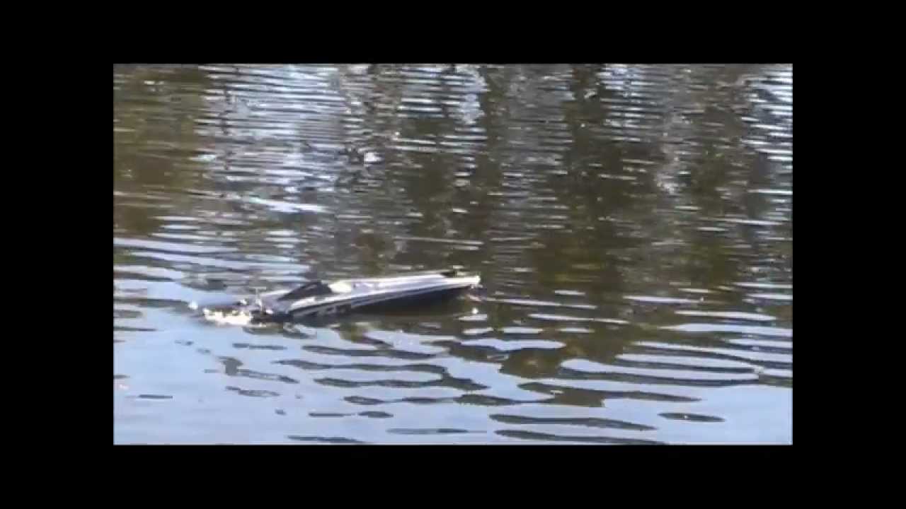

                    Here is the same Zonda, stock from box as delivered by TFL to the resellers.......... with TP3674 + sf200
                    6S.

                      whats a sf200?
                      and wich size props this drive?^^

                          TP 7D 2250Kv 3674. 2x 6S. CNC448/2blade
                          sf200(swordfish200 esc )

                            hm looks nice, gonna thing about it, DRWAYNE!!! you saw my vids that i make for you?
