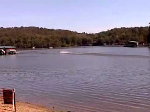

    Got the boat in the water, This weekend raced the boat in the annual fastest RC boat shootout. Got to do some testing, started with my octura 470's raced preped cut to 65mm, the boat would run high 70s, only pulling 110a and temps around 90deg. Rich at central rc boats, hooked me up with a pair of 2720 wheels, and the next pass was 90 followed up with a 91mph pass.
    The water got choppy so the afternoon speeds were lower, got to run a 87mph run Sun afternoon. I am so pleased with this boat. Once I figure out what prop she likes she will be well over 100.

    pratice runs, 91 mph.

      Nice results, well done! Vid??

            Thanks Guys, Bot ran steady 91mph on A pair of 2720 's from abc, motors not even pulling any amps and temps so low it was hotter outside. So I Just Got a new Pair of Vodoo Props 7018-3 's ss good looking props, took a while to get, Cant wait to test her this coming Wen. Let ya know what she does.
