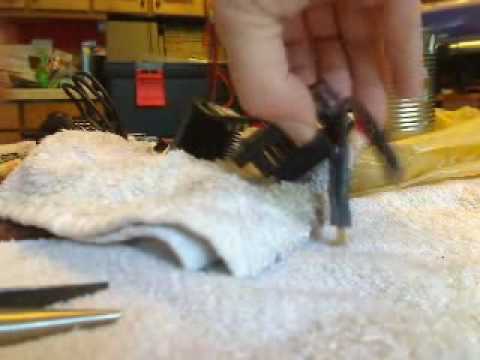

                          • xlandguy
                            • May 2012
                            • 293
                            I've seen videos of folks waterproofing thier stuff with CX. Open the ESC, dunk it completely and reassemble. Supposed to be waterPROOF for months then.
                              WOW! Thats pretty cool. Thanks for posting up
