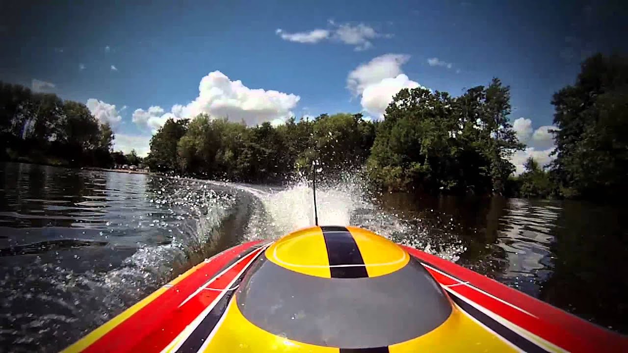

                          Originally posted by 1945dave View Post
                          Did you notice the small very noticable vertical spray separate from the rearward rooster tail? That is from water hitting and being directed upward from that small 1/8th inch gap between the transom mounting bracket and the forward edge of the strut. Two things about that. First it causes a small amount of lost speed. Important? That depends on how important maximum speed is to you. Second, in my case it also helped funnel water into my hull via the mounting bolts which over time wallowed a little bit as the strut and strut bracket rocked on the rounded surface of the transom (I posted this situation in a different post). Anyway, dab a little RTV (silicon rubber sealant) around all edges of the bracket and fill the hole forward of the strut and shoot the video again.
                          Dave
                          Hello all,
                          I did what Dave explained and indeed the separate spray of water vanished,thanks for the tip Dave
                          Below you can see the new video with a touch of top gear post processing... :-)

                            Great Video Paul, I realize I don't use my GoPro enough.
                            Do you still have the standard lens or did you change to the sunex?
                            Are you using the suction-cup mount or the smaller adhesive mount?
