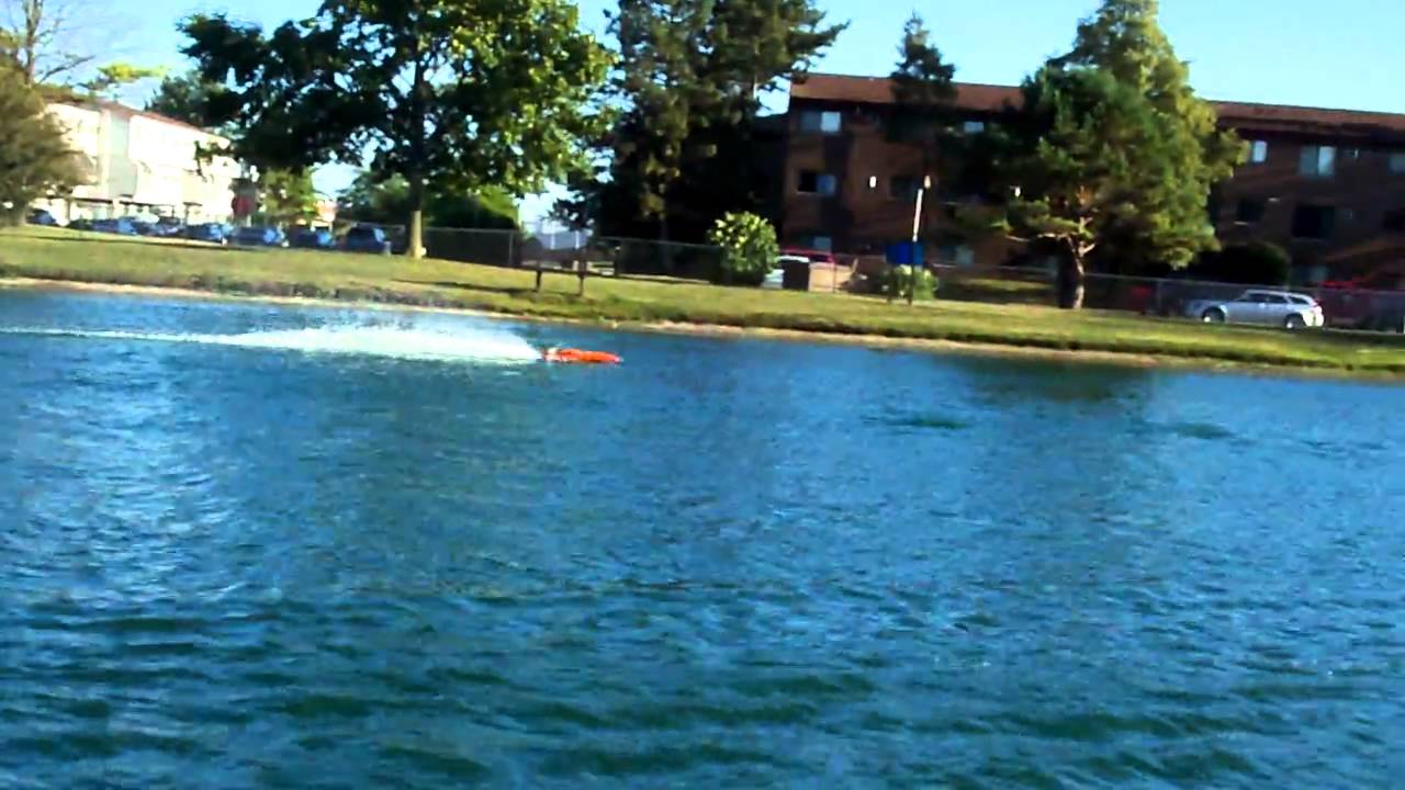

    I just meant the vid ending,no schrapnel,no nose of boat,just gone.A very expensive run.
