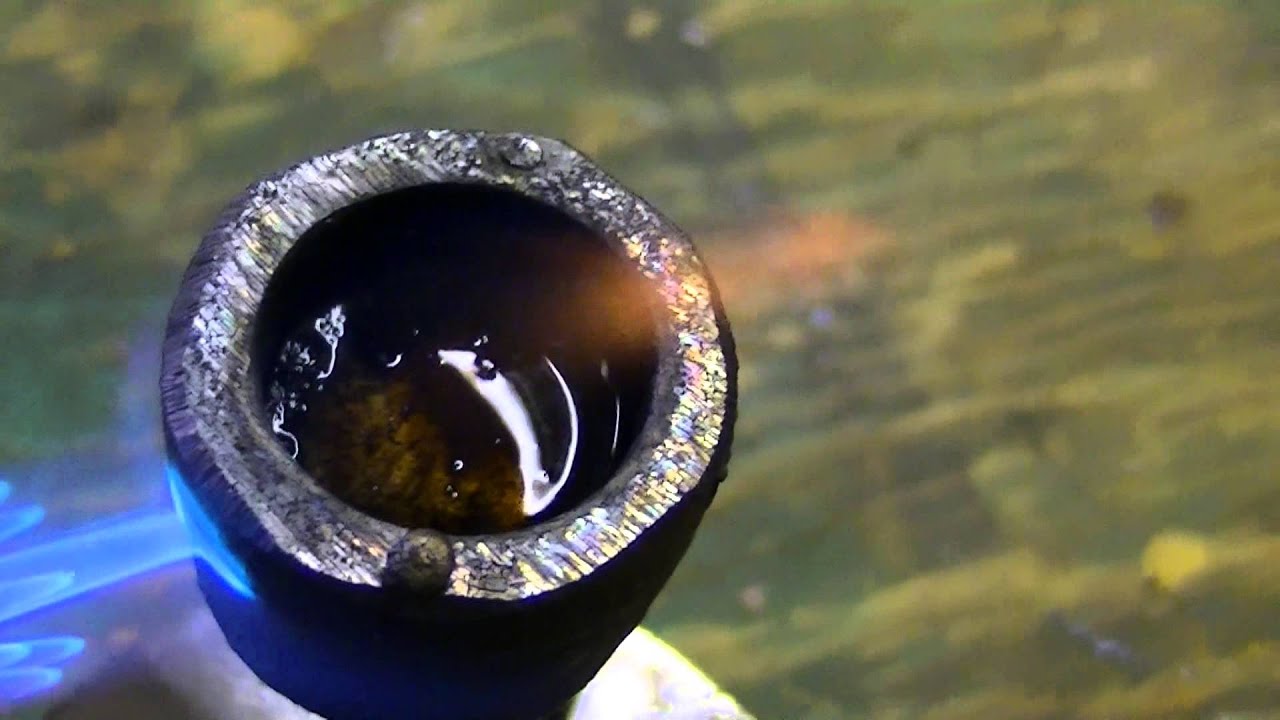

                          I know this is an old thread, but I wanted to share my method of soldering flex cable. The crucible method. I've been just buying brazed cable, but I use this method to close up the loose ends after cutting the cable to length.
