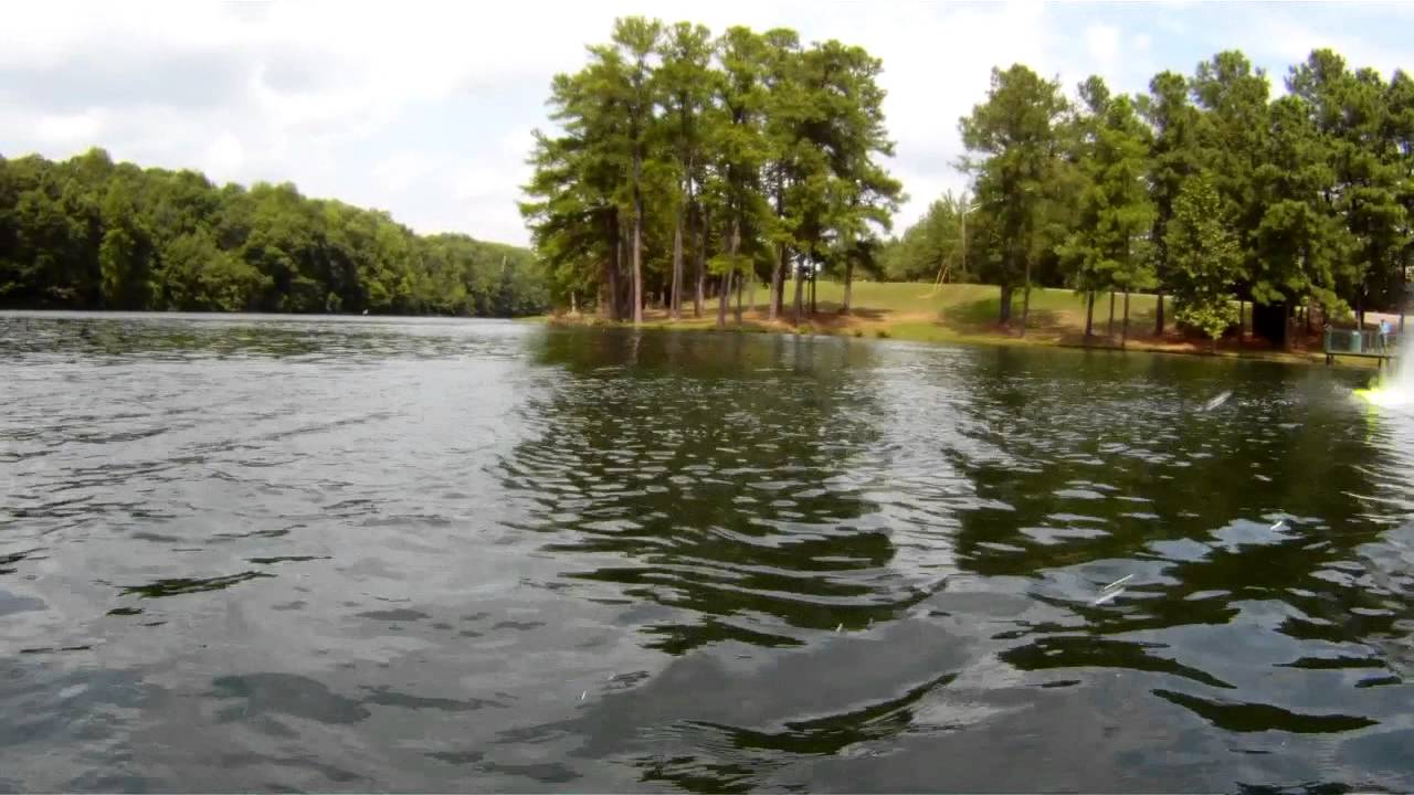

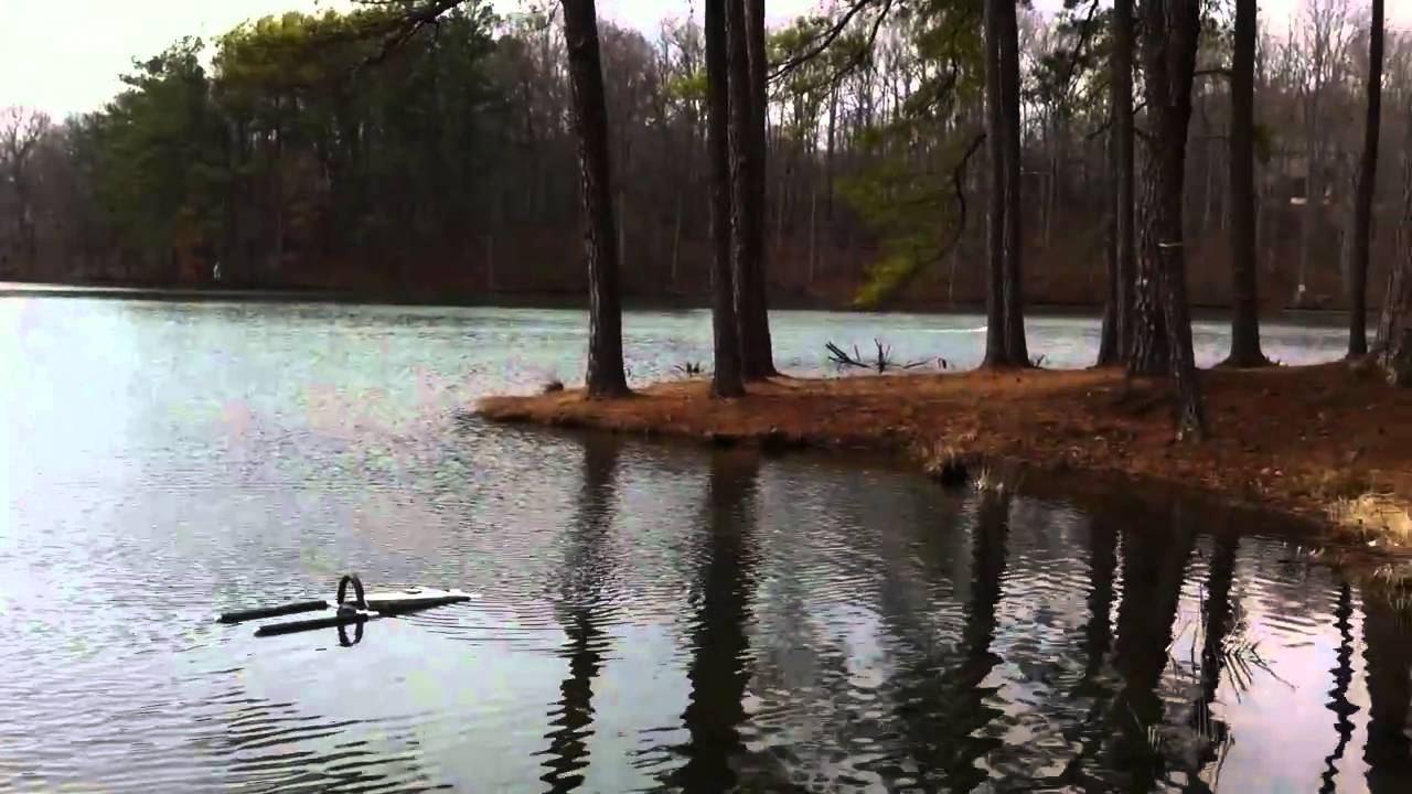

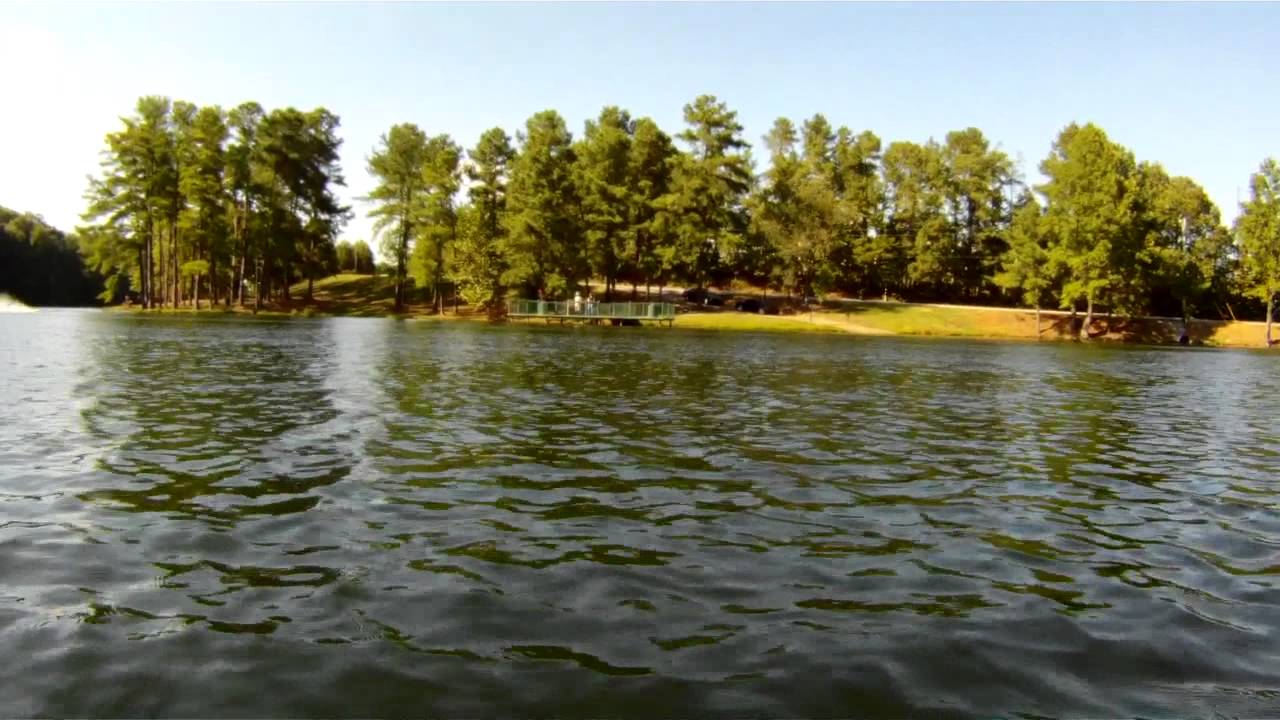

                    Earlier this year i bought a Rio EP just for being the rescue boat. It even has rescue written on it lol.
                    I build these floating rigs that I set the Rio EP into and use the boat to power them. The first version was only to go and catch downed boats. Either right side up, upside down or even buoy nose up. Works great.
                    V1
                    Then a month or two ago I got the idea to add my camera to the rig to go and film out on the lake to get some different footage. I added a camera mount and a base that can move 360 degrees to point the camera around. Added a tethering line for safety to the camera as well. There is also great stuff expanding foam inside the PVC. And I have saftey ropes tied to the camera mounting structure in-case the rescue/camera rig get hit by a speeding boat and it breaks it the ropes will keep it together still. And there are small guy wires on the camera tower to help stabilize it.
                    V2
                    • JPriami
                      N4FOX
                      • 1675
                      #115
                      Videos of recording from rig and of using the rig.

                          nice flip and landing earlier in the video, made it look like a trick, very cool
