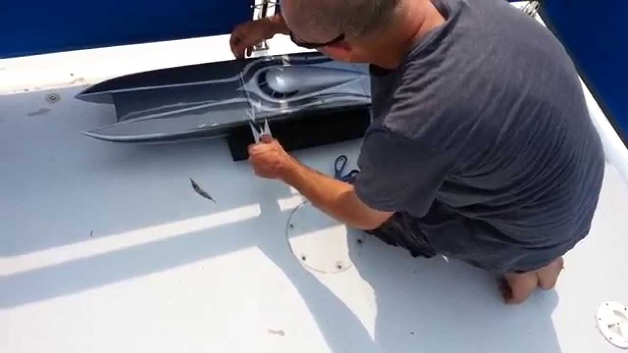

                            Incredible speed
                            Motors are TPPower 4050, MGM controllers, 6S 4000 mAh , Octura X447.
                            I don' t know the kv of TP motors ... May be 2000 kV ...
