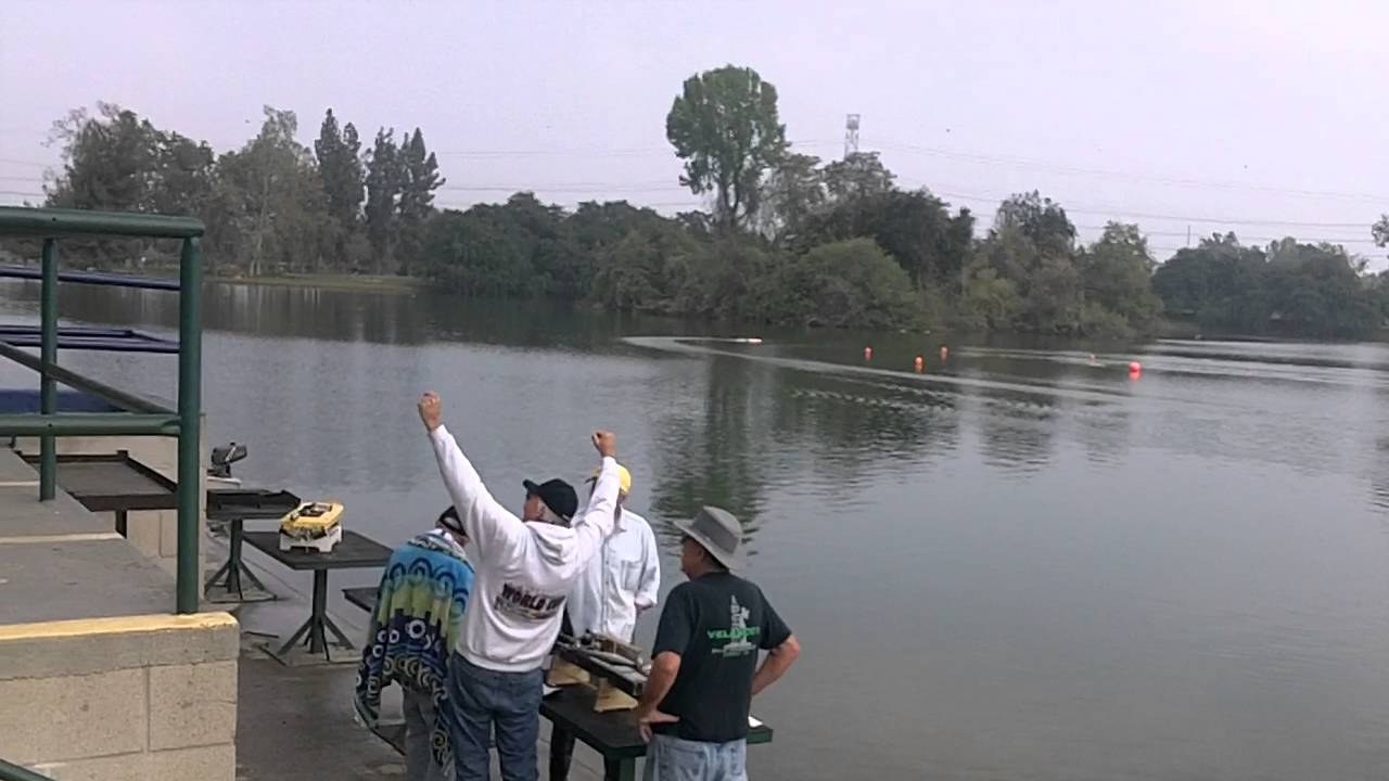

      Here's Darin's 22.7 sec P-OPC Tunnel record run in 2016. Just to inspire you [With cameos by Brian Buass and Mark Grim & my sneezes]
        That is one fast and well set up tunnel.
