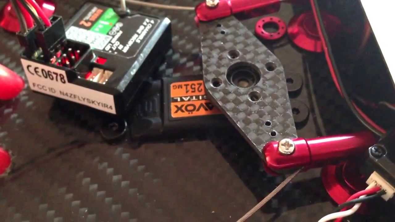

    Hi guys
    I have a problem with the servo twitching in my HPR C5009.
    Some relevant information:
    Servo: Savox 1251MG Low profile Digital
    Radio system: Flysky FS IT4
    I use a 6V NIMH battery to power the RX
    All parts are brand new!
    Here is a video of how the servo acts:
    I have tried 3 different servos, and the all act the same way, so this should not be the problem. I also tried two different radio systems, and they gave the same result. I should although mention that the second radio system was also Flysky FS IT4.
    I also tried using a BEC to make sure the output is 6V, but no luck there either.
    Does anyone have a suggestion to what might cause this to happen?

    Frank did u use the same rx when testing the second radio
    • Rc Frank
      • Nov 2012
      • 80
      No, I used a different RX, so that should not be the problem. If the radio/RX is the problem, there should be a lot of Flysky systems out there with twitching issues!=)

        I had a similar problem with an onroad car. I had mounted my rx on top of the servo, once I moved that the problem went away. Have you tried moving the rx away from the servo?
        • Rc Frank
          • Nov 2012
          • 80
          Tried that just now, no difference I´m afraid. Thanks for the suggestion though=)

              I bought a savox a while back and it did that right out of the box. Not quite that extreme but its noisy and has a slight twitch. Ive had better luck with 10.00 servos from hk.
              • Hor2012
                • 416
                I had the same issue with a 2 different brand servos on my cat. Someone on the forums here told me to get this and never had problems ever again. I don't even hear the servo anymore when it's in neutral position and all the movement and glitches went away. I am 100% satisfied with this item I'm showing you

                  hmm that don´t sound good. But in this case it doesn't seem to be the servo causing the problem, as three different servos gave the same result..

                    that might be a solution! Thanks, I´ll look into it.
                    HPR C5009 - Spirit of Norway
                    • Rc Frank
                      • Nov 2012
                      • 80
                      I think I hav found the solution. This little cute think came with the radio system:
                      And once I plugged in the servo to it, it seems the glitching issue went away:-) I'll post my results once I get some further testing done!
