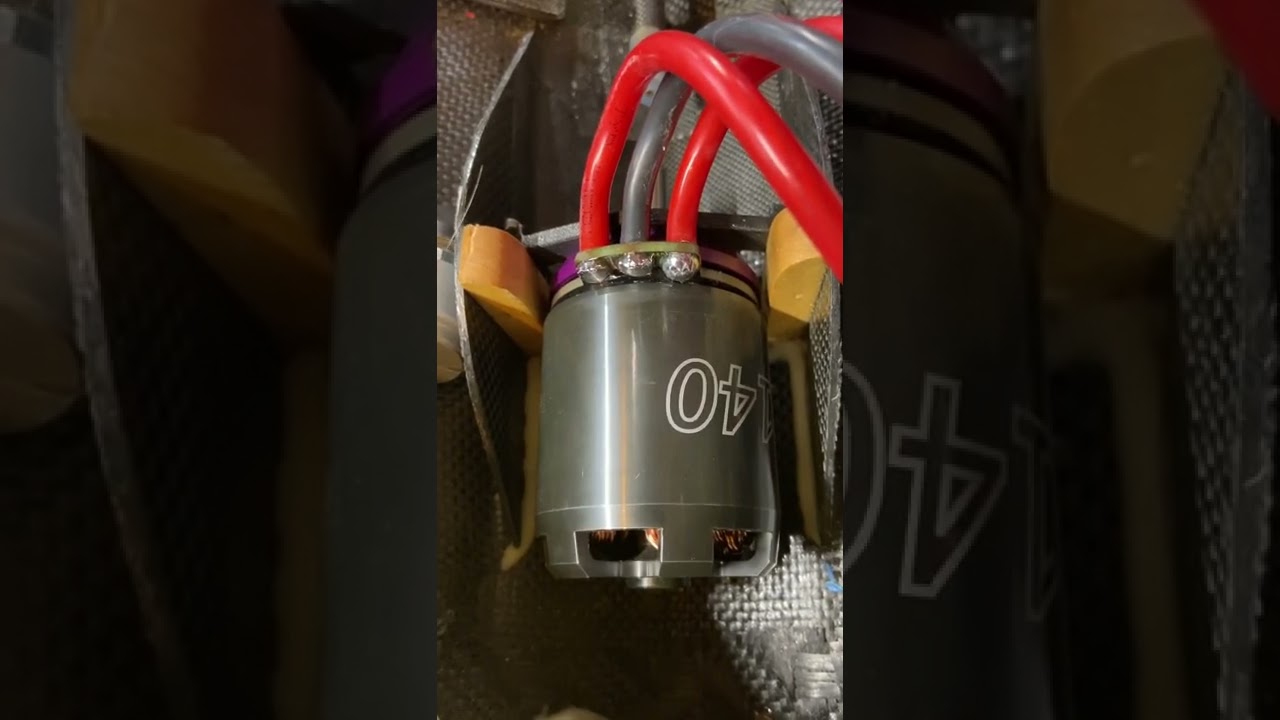

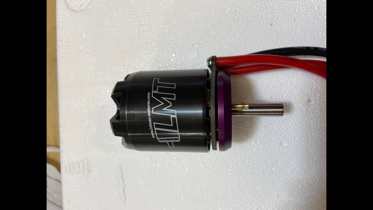

    Hey guys, At the request of a friend I put together a short video looking at the LMT 4140 and 7050 outrunner motors. Second video is of the first spin up of the 4140 on 3S. Sounds lovely.

        The 4140 is going into my DF39 Q mono. The 7050 is waiting for a future project.

            Choose the correct esc regarding the number of poles, that' s why outrunner motors sound incredible. Those Lehner are monsters.
