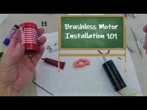

                        Here is a fun person building a hydro a little like yours. He has same motor combination I think...

                          Glad you got it sorted! That's a nice combination.
                          Scott's a real nice guy . I watched this vid yesterday. I do wonder if he drilled out those barbs or if he picked them up somewhere.
                            He installed new ones same threads but larger ID
