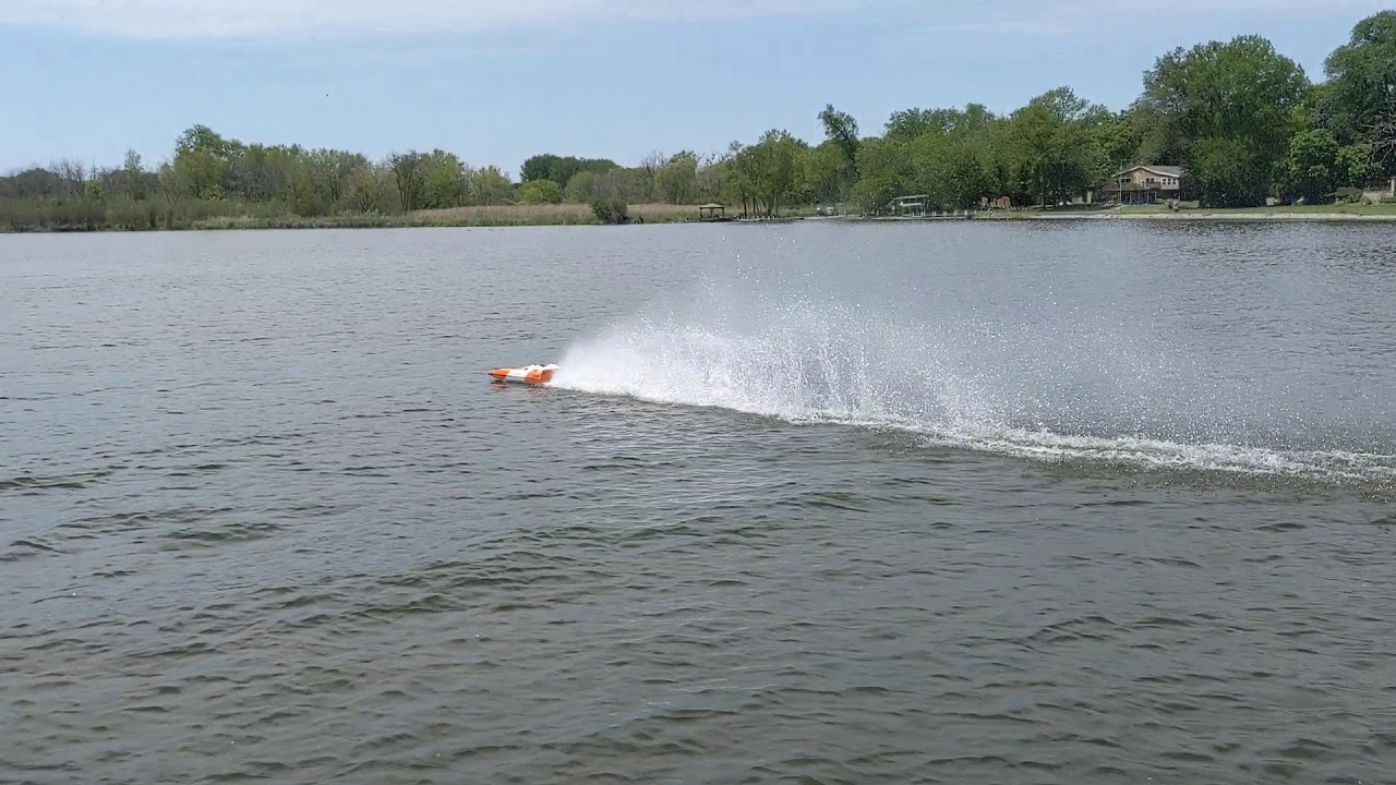

                              Quick update and a couple questions in case anyone is still watching this thread.
                              The black mono has been doing great. With 10Ah 3S battery, it has a long run time. I made a cowl for it out of plexi, but it's cracking where the thumbs screws hold it down. I'm going to have to come up with a better design.
                              The big twin cat is complete and I've put 4 sets of batteries through it. It's a riot in rough water and pretty fast. The question I'm having is that I can't seem to get the nose up high enough. I have the stinger trimmed all the way up, and the weight as far back as I can make it. Should I put some washers on the bottom bolts of the stinger to get some more angle out of it? I think there is a lot more I can get out of it if I can pull the nose up some more. Below is a video of it running.
                                • 7651
                                #45
                                It definitely sounds like it is working at it a little hard. If you balance the boat (Loaded ready time run with hatch on) on a dowel or something Where is the balance point in relation to the back of the transom? It should be about 30% of the length.
