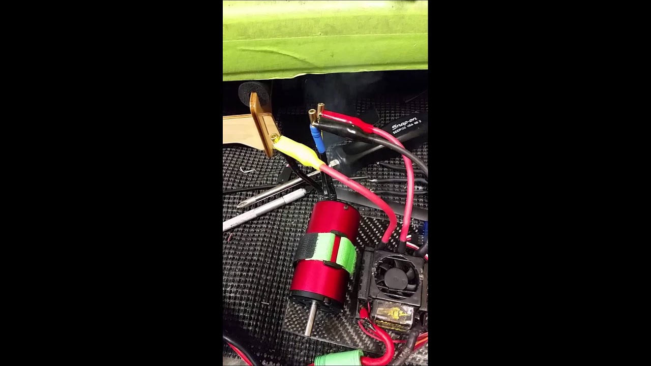

    Well this one was black like the one above but a little worse, but I tested it like this.... (pretty obvious when you see it lol)
    Letting the smoke out is one way to test it, lol. Hopefully it doesn't damage your controller.

      Hey Terry, just think of it this way. You have the distinction of being the first man to toast a motor in RC boat history!
        Travis, I'd think testing it that way would be a little rough on your tester....
          #34
          That's why I'm using a mamba monster. It has protection. I shorted the wires on it the other day by accident. ... it was alot more zap than I expected. But the esc shuts down. Wish all our boat esc's would do the same
