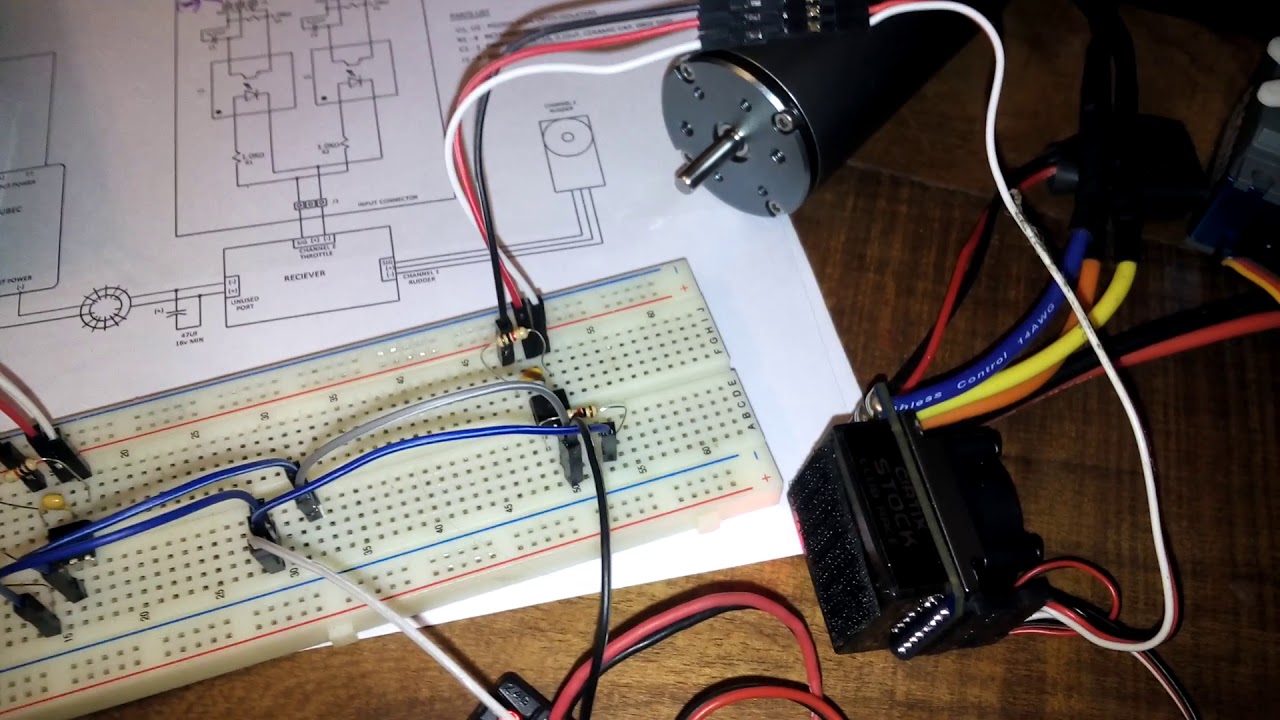

                      • golfito
                        • Sep 2011
                        • 296
                        #161
                        Thank you very much for the work you do.
                        Today I try to start assembling a circuit.
                        *!** The previous one tries to desoldar the resistances in parallel that add them ... but an attack of little patience ended up throwing it in the trash basket ... it worked too, like ?, I still do not know.

                          Did you see the new schematics? You need to increase the series resistor and take off the parallel resistor. Try the values on the schematic, 1K Ohm. This works with Panasonic PS2501, but don’t know if it will work with 4N25. I need your help to verify that. Can you do that and report?
                          • golfito
                            • Sep 2011
                            • 296
                            #163
                            Craig,
                            I just tried it on the breadboard and the ESC does not work. TX / RX turnigy / flysky, optp 4N35, 1k resistors
                            • golfito
                              • Sep 2011
                              • 296
                              #164
                              Invert the signal and ground wires at the output. Remaining the first circutito that I present. And it worked!
