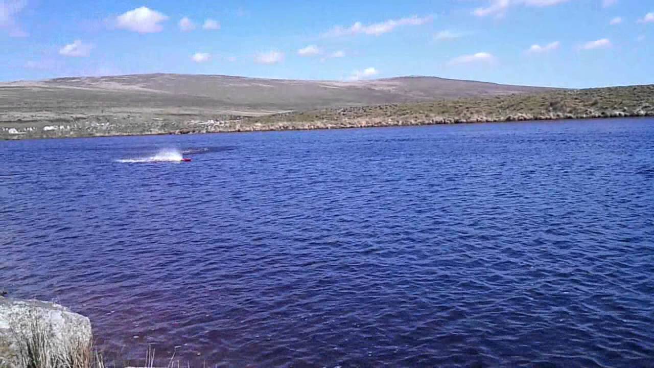

      I will upload a vid of the run shortly. You will notice the water was like glass today so I was a bit annoyed when the fun was over only 2:30 in. Temperature outside was 25C .I had also charged up the Hyperions to run after but ended up taking them home to discharge on the I-charger. Stinger angle could of done with being adjusted to suit the water.
      Let me know what you think.

        Here's the vid

          Lots of on and off hard throttle is very hard on any esc/battery/connector combo. Also running the lipos past their 70 percent capacity will make the best lipos swell. I have some swollen 3s 4200mah hyperion packs that I run in my Emaxx, but they still work fine. Test by trying to simulate a real heat race (1 or 2 mill laps followed by 5 EASY on the throttle fast continuous race laps)

            Yeah I never run the lipos past 70% but I am guilty of the hard throttle. The extra connection of the eagle tree was the main problem. I reckon the connections would have been fine otherwise.

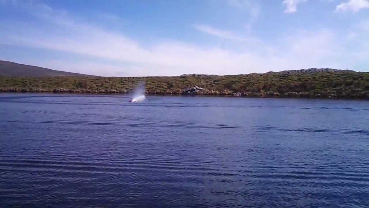

                                Hyperion
                                They ran great as usual but run time was less. Around 6 mins total.
                                Top speed was 45.3MPH
                                The voltage dropped so fast that it was at 3.76 then 20 secs (actual time) of running later it was 2.97 per cell. My lipo protector is set at 3.4V, it went crazy beeping all of a sudden. The cells did not even puff/swell and they have gone back up to storage values no problem. Will have to sort out this voltage drop problem though.
                                Sorry for the short vid. I had another better one but deleted it by accident. I was meant to delete this one
