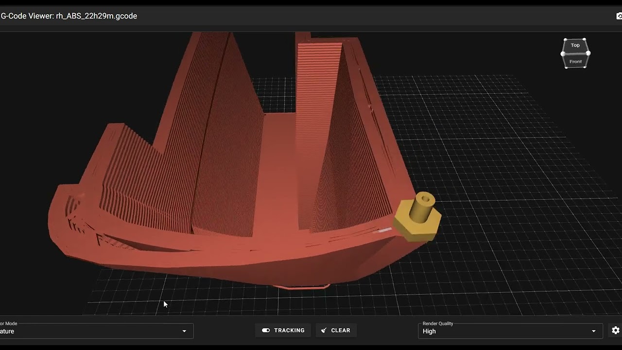

    hers a video of the stl file sliced showing the subdivision of the hull into chambers.
