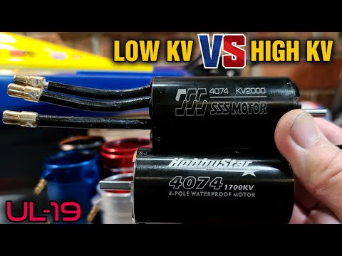

    Would a SSS 4082 2000kv motor be appropriate for this boat on 6 s?

    Size seems appropriate. I think I would go for a little lower KV if you plan to run 6-s exclusively.

      So maybe around 1600? I hear 4s runs decent in these huĺls, but I do hope to run 6s mostly if it's not too much.

        when running mono's you're highly limited on prop size and pitch. The only way to really get real high speeds is higher RPM. The 35k peak RPM "rule" has to be thrown out. What you can do is run the 2000kv then turn down your motor timing and turn down your throttle end points. So you're "over spinning" the drive line then throttling back through your radio and timing. you can then slowly ramp in the power and check temperatures gradually.

          Of you have already purchased the motor ( 2000 kv ) I don't think I would set it aside. If you haven't bought it yet, it looks like sss sells a 1650 and leopard sells a 1800. I would choose the 1800 if it were my boat. The closer you get to the ragged edge the harder it is on the ESC, and the smaller selection of props your equipment can handle. From your question, I don't think you intend to race it, just sport running. I am not a fan of the methods
          suggested in the above post. Buy the right equipment for your intended use
          and it will give you years of enjoyment.

              I do not intend to race this hydro but of course I like to go fast. I haven't purchased the motor yet, but I have everything else hardware wise that was recommended. I thought 2000 kv might be close to edge, so yeah I'll probably do 1650 or 1800. I do appreciate the info for sure.

                  Tim, I would go 1700-1800kv for 6s. It should be stable enough to provide plenty of fun. There is lots of tuning once you hit the water to better the speeds

                    I'm going to chime in here and seriously challenge the high rpm carry on. For someone racing or just sport running, 1400 kv can get you 60 mph+ with a good prop. If zoom zoom, then higher rpm is fine. Lower kv however gives you more resilience against over propping, less chance of burning up gear.
                    I currently run a 36" ex nitro sport hydro. TP 4060 1350 kv, 6s turning an ABC 1915/17/45. This pushes over 65 mph, and in a race can be a handful in traffic. However it is a solid setup that gives no trouble.
                    I would recommend the TP 4050 1570 kv motor. I have that in a DF Pirate and that runs around the 55-60 mph for race or play.
                    Your bigger issues will be keeping that hull on the water over 60 mph.

                        I really appreciate the info guys, I ordered a TP 4050 1570 KV. I think Peter summed up my situation pretty well. I already knew due to the full length tunnel on this boat that it's gonna trap a ton of air. So as Peter said 60ish and staying on the water will probably be tough. This motor should give me good run time and lots of prop choices. So I'm still at a 4082 size just lower kv than I expected.
