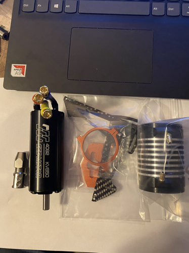

        Welcome back! Thanks for the vote of confidence on the strut, took a while to get up the courage to cut into the hull.
        This is the motor I went with. The vendor is semi local to me and has been super helpful with the parts I need.
        Motor Combination includes Motor, Mount, Water Jacket and 8 mm Collet. Motor has 8mm male bullets installed. NAMBA APPROVED MOTOR IN 1/8 FE

              Some great updates. The motor looks good - 850KV, what voltage pack are you planning on running?
