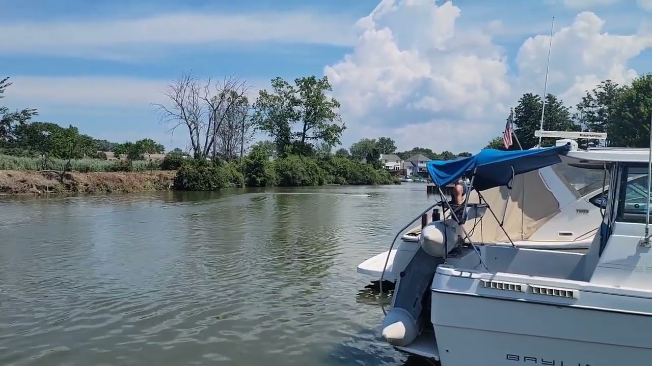

                        #86
                        Made my second attempt running the boat today. Got almost two minutes of running time before my starboard motor collet spun loose and lost both the prop and shaft. I don't understand why it spun free, as I torqued down real good, as I always do and I made sure to wipe the cable of any greese before it entered the collet...Amd I decided to not put on the cable savers this time; bad decision, I guess. But anyways, I did get some video of the run.

                            #88
                            Paul
                            You be careful running around real boats.
                            A few years a young kid was running in a marina in Rochester NY.
                            He lost his radio connection, his toy boat hit a brand Sea Ray broad side. tied to the dock.
                            The Sea Ray sank on the spot. 10" hole at the water line.
                            His father lost his big boat, and part of his house.
                            His insurance would not cover him.
                            Larry

                              #89
                              Thanks for expressing your concerns Larry, and sharing that incident...Something like that happening is always in the back of my mind whenever I run my boats at my marina. I always try to be as cautious as possible, but understand anything can happen in this hobby.
                              Unfortunately I don't have anywhere else to run my boats at in my area. There's a pond at a local park I also use sometimes. But not very big, and is generally unusable because of the algae growth most of the summer. Lake Erie is not an option because water conditions most of the time are not suited for running on.
