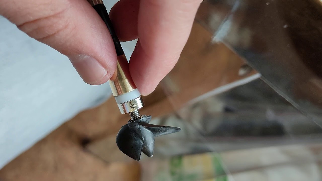

                            Guys, is this correct? There has to be a bit of clearance there right? The propeller does not go any more in, it does not matter right?
                            • Jesse J
                              scale FE enthusiast
                              • Aug 2008
                              • 7241
                              Is this a wire drive or flex? If flex, then not enough space. If wire, then this is minimum.
                              Space in front of prop is not problem.
